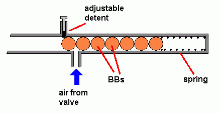

How about an inline magazine like SPG proposed here?psycix wrote:Ooh neat T-piece!
I still haven't figured out what to do with mine.
The only problem I can see is the BBs in the mag coming back with such force after the air pressure is down that they might skip the detent, hence adjustability is a good idea.Basically just a barrel extension running rearwards from the T-piece, with the air from your valve coming up the T instead so that it enters between the first two BBs?
Nice and easy to do, no worries about double feeds as the air would push the remaining BBs out the way, and that way you don't have anything sticking up out of the gun to snag/get in the way of sighting.
It would look something like this:

Neahhh I'm not feeling much for it. Makes your gun very long, thus taking up barrel length.jackssmirkingrevenge wrote:How about an inline magazine like SPG proposed here?psycix wrote:Ooh neat T-piece!
I think I'll skip the BB blowforwardbolt for now and build one for marbles...

The graphic is close to what the model battle ship guys use, but for the resistance, they use an o ring. Sorry no photos, but a description is here.jackssmirkingrevenge wrote:I find that adding short length of tube full of lead in the magazine after the ammunition helps with reliable feeding, a sort of "gravity powered spring"I think most of these mags have a sort of "sweet spot" when it comes to ROF, it is just a matter of tuning the gun to match

You could loop it back through 180 degrees and have it along the barrel.psycix wrote:Makes your gun very long, thus taking up barrel length.
