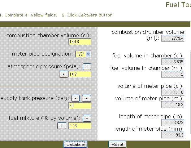

working on making the combustion run on propane, but i think my #s are off, http://www.burntlatke.com/ft_live.html says ill need 20" of 1" pipe for my meter, or 24" of 3/4'' pipe, the chamber is 3" abs by 24"

Northir wrote:working on making the combustion run on propane, but i think my #s are off, http://www.burntlatke.com/ft_live.html says ill need 20" of 1" pipe for my meter, or 24" of 3/4'' pipe, the chamber is 3" abs by 24"
It does sound a bit off, this is what I got:
fuel calc.GIF (17.53 KiB) Viewed 3108 times

yea a 20" length of 1" pvc seems a little big for metering propane. i made a combustion tennis ball cannon with a 4 x 18" chamber and if i remember correctly, i think my meter pipe was, er, like maybe 6" long and 1/2" diameter.

i guess i should have noted my tank is 50 psi not 90, either that or my pressure gauge is borked
Sun Oct 04, 2009 8:59 am
Northir wrote:i guess i should have noted my tank is 50 psi not 90, either that or my pressure gauge is borked
In that case pressure is about half, so the length of the metre pipe approximately doubles.
