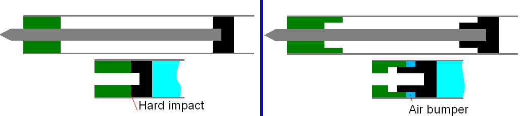

This is something I also wanted to try out for ages, but with a longer barrel, and some sort of buffer spring to stop the piston from getting wedged.
To be able to remove arrows from the target (unharmed) tips like this (or the middle black one on this pic) make the process much easier, but then they will also tend to fly right through thinner targets.
You could reduce the impact of the sabot by using an air-bumper.
- silencebumper.PNG (9.09 KiB) Viewed 5346 times

Rubber might deform and leak air from the air bumper. Since the air bumper already takes the impact, this means that you could use something else, like a lathed piece of plastic.

The arrow closes off the front, Psy..
So you don't need the complex shape..
Just any piston will face one big airbumper the way you've drawn it..
It needs ventholes, but placed strategicly.
Not too far back, because of the need to trap the gas, not too far forward either.The section in between is your airbumper.
We could also leave out the holes and use the frontal area to spit out the arrow even faster.Or perhaps use it to diesel..
In that case the piston needs to seal 100%, an o-ring should be around the arrow and the back of the arrow should be exposed to the pressure.
I.o.w. not seal against the piston..
But that would probably make it less silent.( esp. dieseling).a nice experiment, yes, but not the goal for now.

A lightweight piston and a decent bumper is a good start, have a look at nailgun design:jhalek90 wrote:any ideas?
Some sort of tight breech/detent that would prevent your projectile moving before a certain pressure is reached would also allow the air in the piston to act as a better cushion, as well as increasing power.
