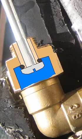

Jenecplu wrote:I have removed the blowgun and replace it by a sort of hammer valve homemade. But I don't have room to put a spring in the handle to trigger the HV. So I incline the screw with my finger, it's easy. All I did was fire to empty at the moment, but it looks better than the blowgun.
Could you give us some details on the homemade valve ?
Maybe a cutaway view drawing ?
I kind of have a picture of the internals, in my imagination. But it would be nice to see the parts and a drawing.
Thank you.

Oxbreath wrote:Could you give us some details on the homemade valve ?
Can't imagine it being more complex than this:

Jack's right, either that or he used some washers and nuts to seat an o-ring. Is this the same guy that made the trigger pull QDV in a tee? If it is then he probably used the method I described.
