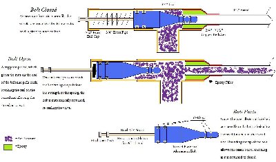

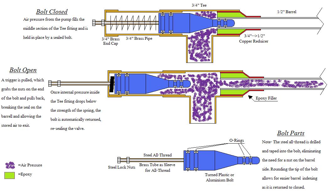

Ok... taking a few things that were mentioned and redesigned the valve
Lighter Bolt- Turned from plastic or aluminium
Less parts- Also cuts weight and troubleshooting
Less Labor intensive- Everything but bolt body is plug n play.
Thoughts??
Valve in a Tee<br />(version 2.0)

The pressure is not equalized in this design, the piston would just open as soon as you started to add pressure, along with this problem even if it was to work the piston isn't floating on the bolt, so you would probably get injured trying to use your hand to pull it.

I think your thinking of this valve design as a typical piston type, where you have 3 ports: one barrel, one tank or pressure system with pilot valve, and one exhaust reservoir, similar to a QEV or sprinkler valve.
Its actually very closely related to technicians QDV as explained here.
http://www.spudfiles.com/forums/t-t17858.html
It differs in that: his is housed inside a tank, and mine is housed inside a Tee fitting.
The bolt wouldn't move as you begin adding pressure, the o-rings would catch and seal on the tubing that it sits in.
there is no "equalization of pressure" because the bolt/piston is operated manually (eliminating the need for a pilot valve because there is no pressure behind the bolt/piston)
concerning the o-rings, perhaps my drawing is inaccurate but the design does indeed call for floating o-rings in all 4 locations (creating a tight seal keeping air ONLY in the center of the Tee as depicted in the drawing... until you intentionally pull back the bolt that is.).
You are quite correct in your comment concerning operating this valve by hand... it would hurt... the all-thread is tapped into the bolt/piston and the whole assembly moves as a unit. However, it wasn't designed to be operated by hand. The steel lock-nuts on the end of the all-thread act as a ledge that a standard trigger assembly can press against, basically operating it remotely. Quite similar to the way this airgun engages the slide valve.

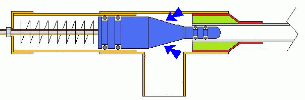

ThornsofTime wrote:Please read and understand before posting. The picture clearly illustrates and says that its operated via trigger, among other things. Instead of just saying "WRONG" some thoughts as to how to fix the possible issues would have been nice. I dont mean to come off as a jerk, but I worry that others will be less likely to study my diagram once it has been discounted, and I truly want feed back (even if it does turn out to be a flop).
He's actually right, due to the disparity in seal diameters (o-rings at the front and back of the "piston") there is a net force from the air pressure trying to push the piston back as hinted by the blue arrows, which means that as soon as you start to pressurise the piston will start moving back and open.

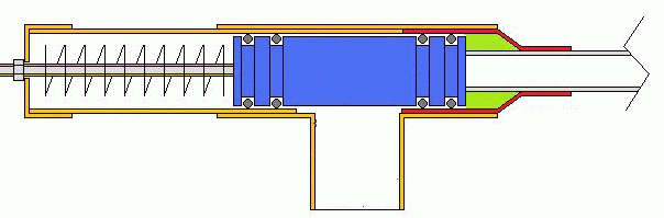

I took the liberty to modify the drawing to fix the size issue that would open the valve when the chamber is filled and added the port to retain the o rings.
I did not take the liberty to fix the rod issue.
Another variation that could work well is to use a smaller diameter piston (will fit in the barrel) and extend the barrel through the T with traditional QDV ports cut in it. Either variation will work well. The larger valve in the drawing below will have lower pressure loss through the ports due to the large area and resulting lower velocity in the port area.
Modified piston to fix unbalance.

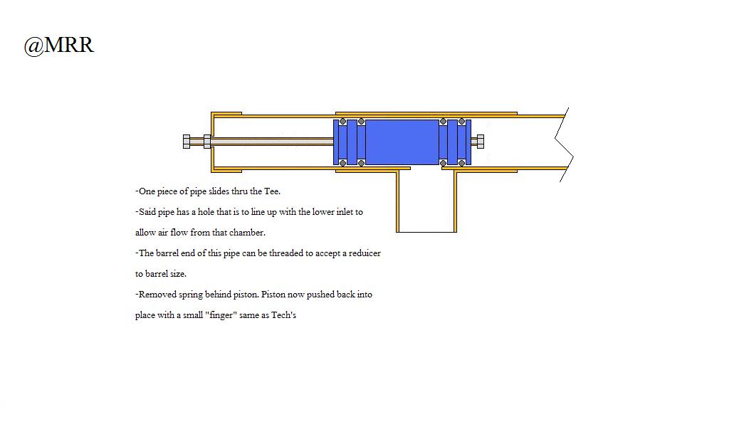

@MRR- I THINK I understand what your saying. Is it really close to the modified diagram Technician made up?? Using his piston design you need a small space between the end of the piston and the barrel, to allow for a Nut on the all-thread that now passes thru the entire piston. Probably solved by just cutting off the pipe @ desired length and adding a reducer that matches barrel size.
Not sure I understand the compression fittings comment. I see a need to weld/solder the pipe to the tee fitting to keep the pipe in place, but could you further explain the compression fitting idea?? If it keeps the pipe in place without welding im ALLLLLL about it.
