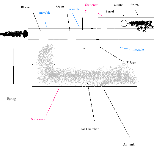

but I'm aiming more for a barrel like that, like a bigger thing. The barrel part will contain barrel, magazine on top of the barrel and air tank below the barrel...look at my really bad drawing xD. The white part will be the actual barrel, the top black part will be a bit smaller and house the magazine, the lower black part will house the air chamber. The whole thing will be 1-1.5 inches wide, and about 6-10 inches long. And also, no, that is NOT what she said.
Also, I really wonder how he made those metal parts...
but I'm aiming more for a barrel like that, like a bigger thing. The barrel part will contain barrel, magazine on top of the barrel and air tank below the barrel...look at my really bad drawing xD. The white part will be the actual barrel, the top black part will be a bit smaller and house the magazine, the lower black part will house the air chamber. The whole thing will be 1-1.5 inches wide, and about 6-10 inches long. And also, no, that is NOT what she said.Also, I really wonder how he made those metal parts...

I thought up of mu own..piston/valve thing, drawing diagram now...
- MY VALVE.PNG (21.46 KiB) Viewed 3458 times

wow and I thought I am the guy who draws crappy diagrams
It's kind of hard to guess what you want to build... it looks like an inverted QDV or a spool valve... well if I was right then yeah - it is possible
What is so bad about a 3way valve + QEV combo ?? hmm ?
Ok ok you can build whatever you want
Though if I were you I'd use a slightly different design... one that uses just a barrel with two ports cut in it as both the main valve and the loading mechanism/bolt... I deleted paint from my system so no I can't post a diagram

I drew a really good one on paper, but my stupid printer decided today wasn't a scanning day, and I wanted a diagram up before anybody questions it, so I just drew one really fat on paint.Basically at Nuetral, air goes nowhere, when the trigger is pulled, it pulls the barrel back and it'll flood with air, this motion also loads the next ammo
Also, I'll have to make my own grip and trigger now, blowgun triggers won't do any good here
