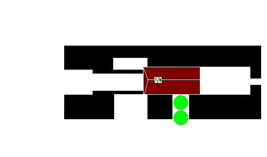

Tue Mar 11, 2014 4:16 pm
I think it makes more sense to separate firing and loading phases so I am not a big fan of open bolt designs
Here's some food for your thought. It's a completely inverted system - loading takes place during pressurising the gun which minimizes performance loses.
valve+loading mech.PNG (5.51 KiB) Viewed 6191 times

Thanks Poland Spud, for the time to create/ post your design drawing, but I am not sure I follow...
