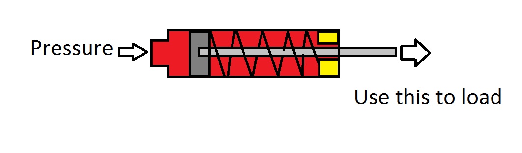

Looks wonderful so far!
A plunger with a spring behind it could cock the mechanism.
As pressure increases in the chamber, the plunger ( like in a bike-pump) will be forced back while it cocks the hammer.
As you fire, pressure will drop and the plunger is forced back by the spring so it picks up the hammer again.
This should work with a small diameter plunger.

thank you for your thoughts, I appreciate the compliments.
Again "Brian the brain" make a drawing please, my English is not that good an I get the technical terms mixed up.

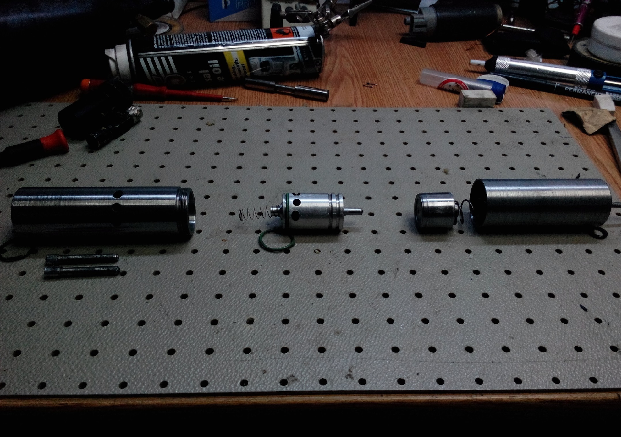

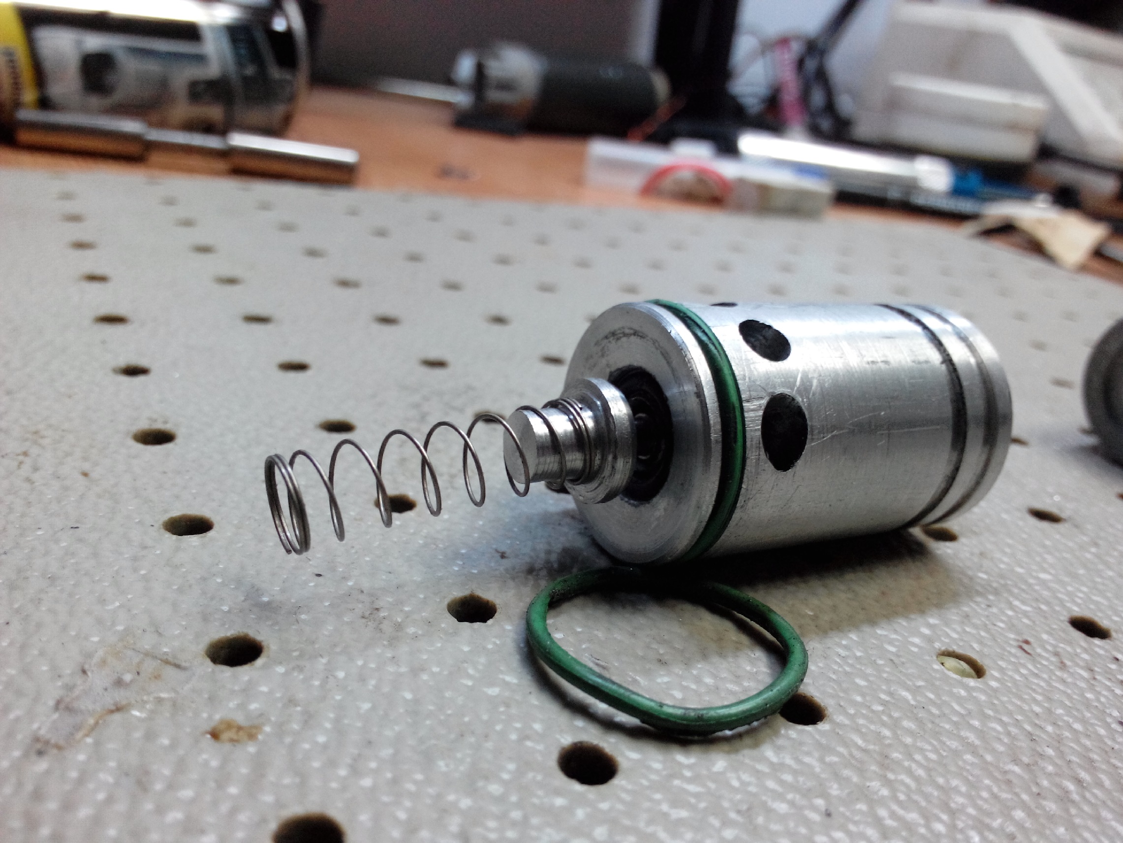

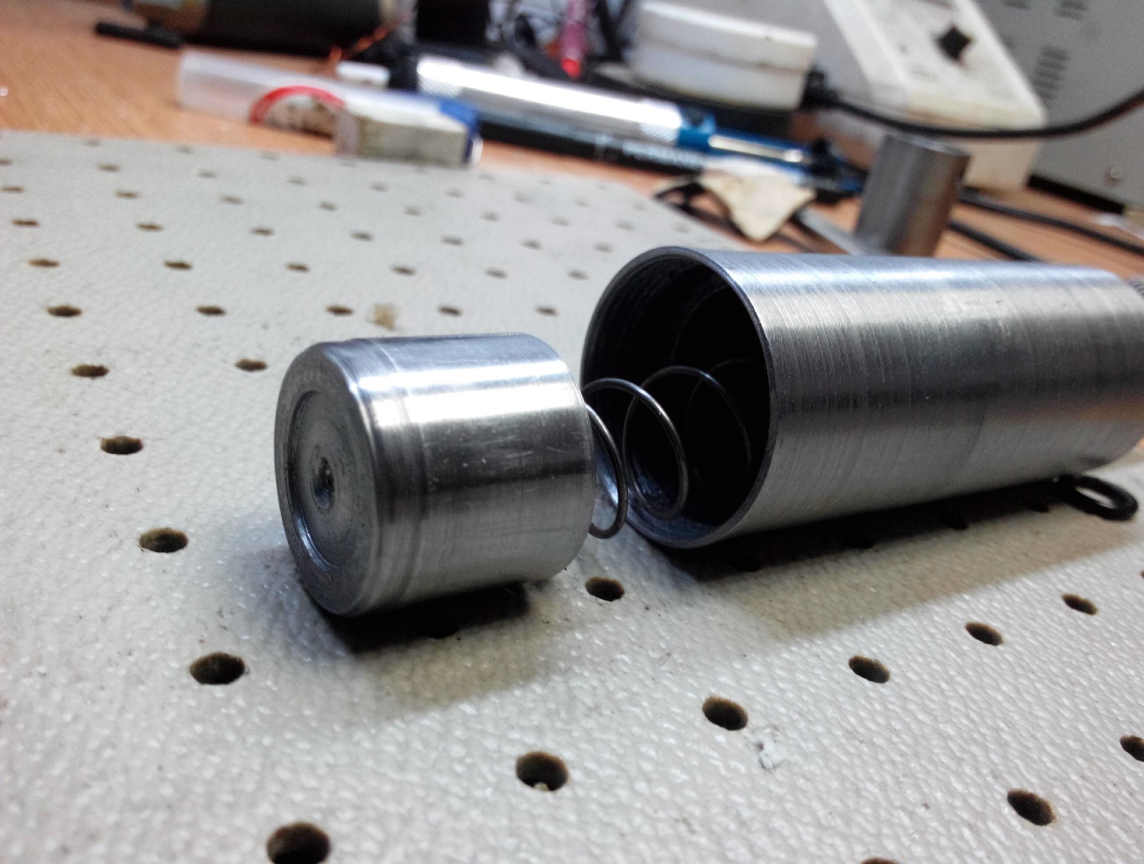

Some damage shots:

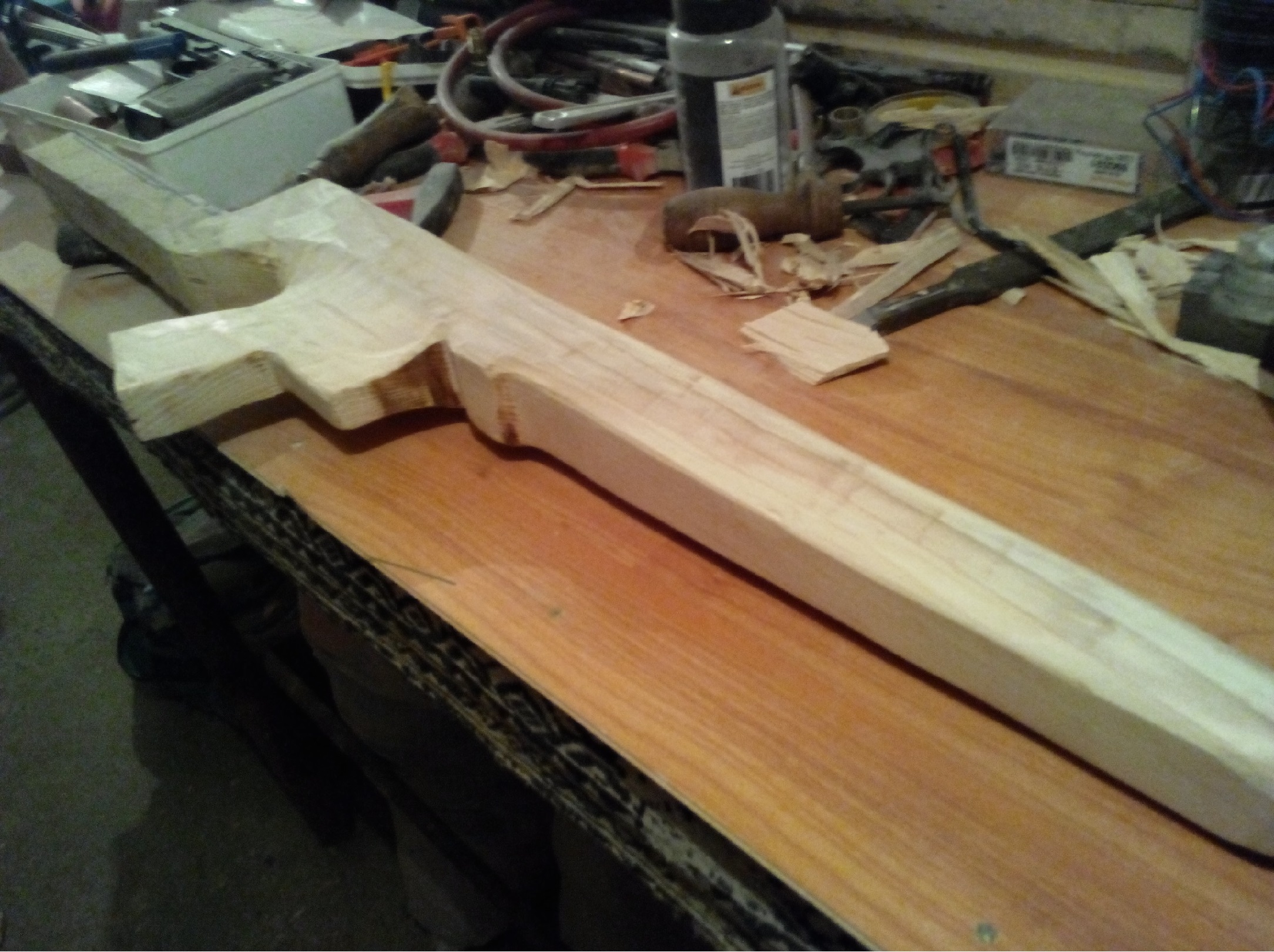

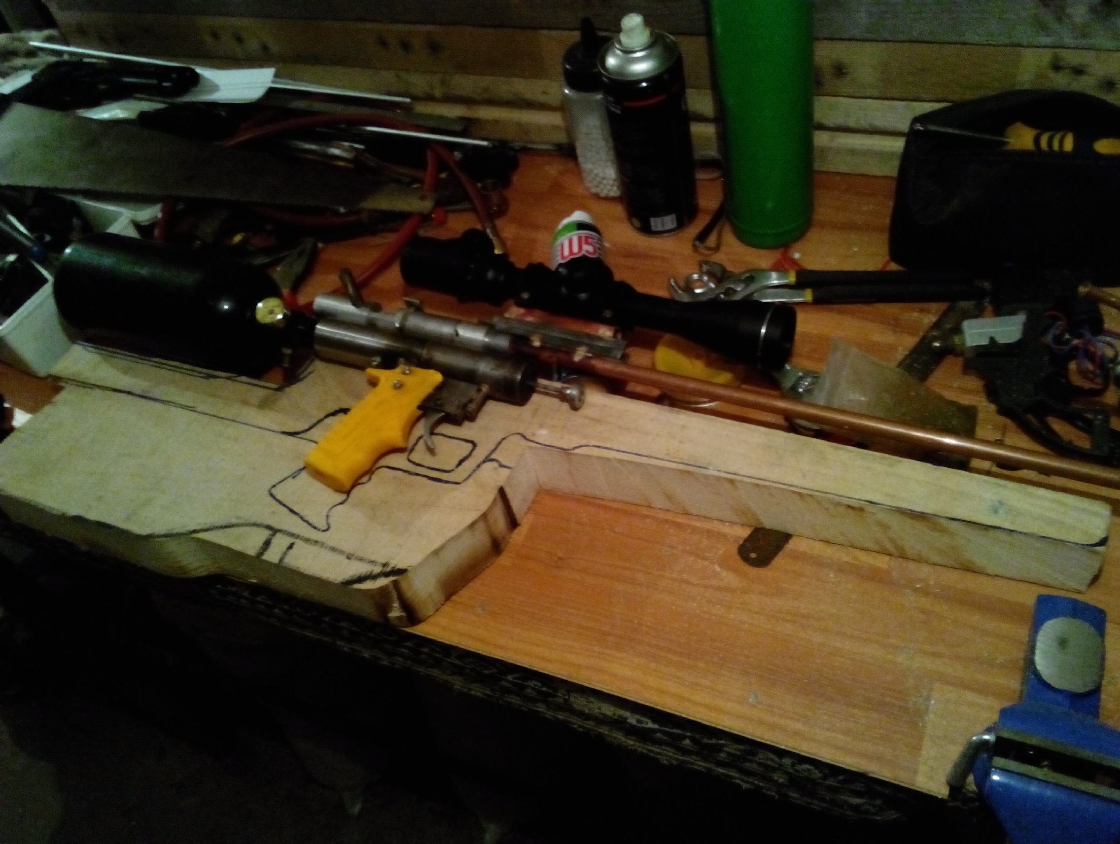

my latest work :oops:
I had to put that handle because it was hard to pull the trigger without one.
Definitely not the final look, my scope has to arrive on Monday, and I need to make a risen rail for the scope. And of course some king o stock ... haven't decided on the model.
A simple piston connected to the chamber.
When the chamber is full, the piston moves the bolt one way, when the chamber is empty, the spring will push the piston in the other direction.
You can use this to auto-load without losing performance.

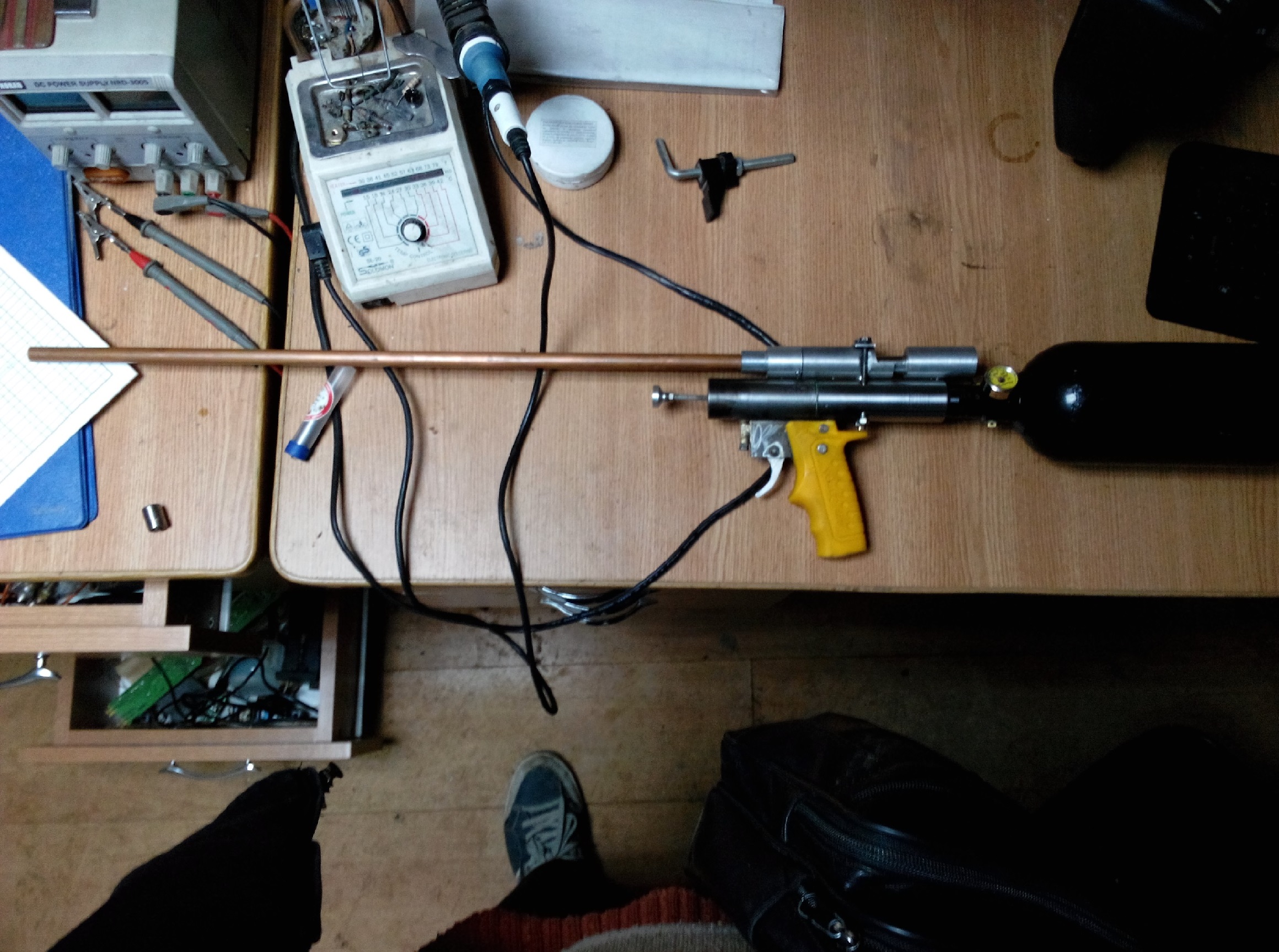

Fri Mar 21, 2014 2:52 pm

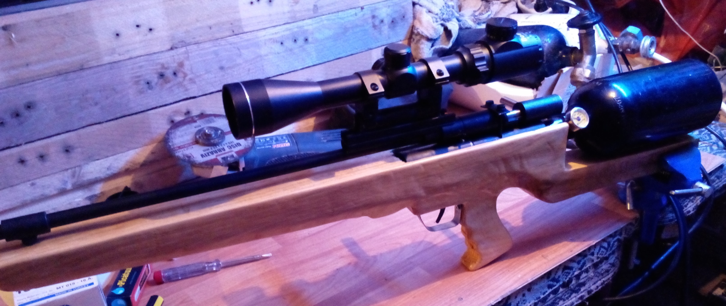

my latest work ... and the new scope

with stock assembled

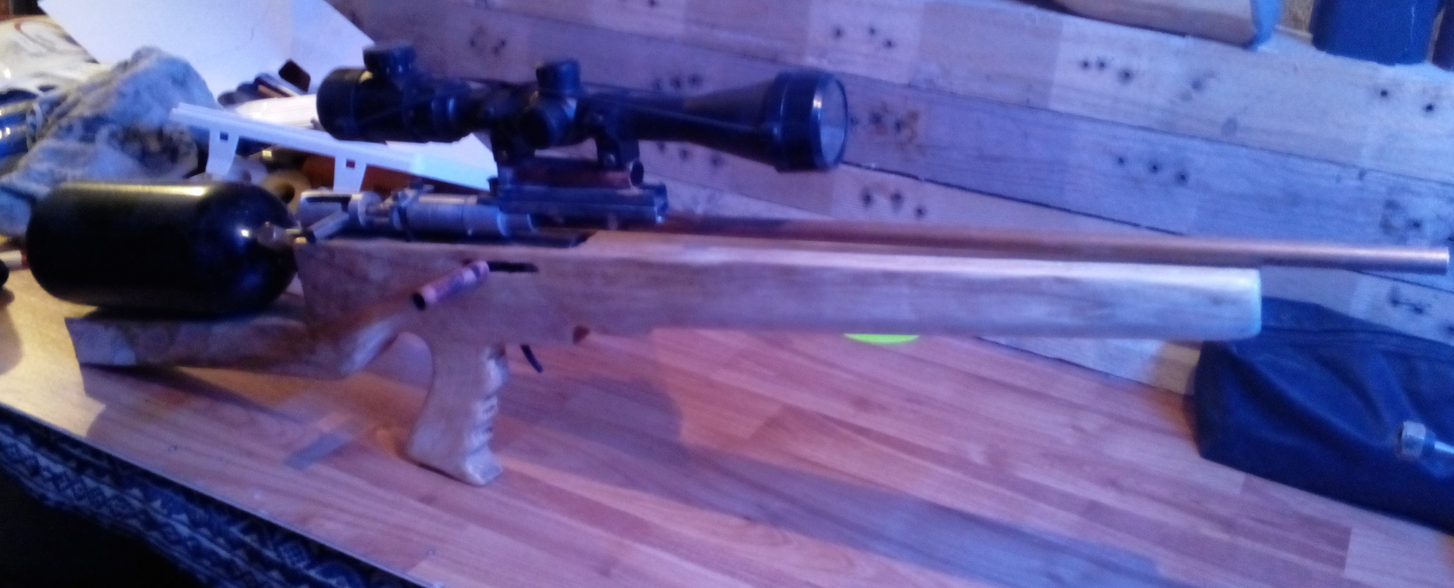

Tue Apr 01, 2014 1:58 pm
almost done
