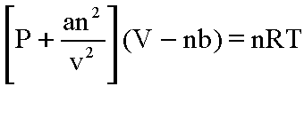

Fri May 16, 2008 6:03 pm
Liki, you are completely correct, the 'ideal gas' does not exist. That is why we must use V=((nRT)/P)+nb where 'n'= moles of gas and 'b'= a constant intrinsic to each gas to account for non ideal gas volume.
And corrected for intermolecular forces, it is P=((nRT)/V)-(a(n/V)^2)). Here 'a' is a constant intrinsic to each gas.
We of course owe a great deal of gratitude to Van der Waals for figuring these corrections, and combining them into the Van der Waals equation. (No one ever said he was humble.)
Equations are very jarbled in regular text, so I used an image to represent that equation in it's common form.

BCPnuematics wrote:That is why we must use V=((nRT)/P)+nb where 'n'= moles of gas and 'b'= a constant intrinsic to each gas to account for non ideal gas volume.
Now i may not go into that with a chem 1 class, but i never knew that. So thats what you use here then, right?
My hats off to you sir :salute:
