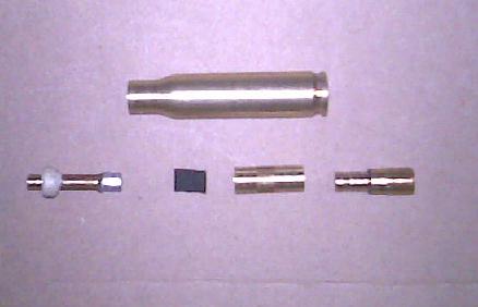

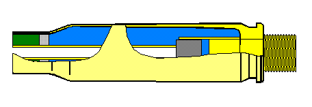

Maybe bolt action isn't such a bad idea... I was mocking up a 7.62x51 cartridge with a schrader, basically a smaller version of what jook13 did here, hmmm...

- Here's the idea, 3mm barrel in a 7.62x51mm cartridge
- 762-3mmcartridgeconcept.GIF (3.32 KiB) Viewed 6040 times
- edit: yeah, let's give it ago. here's the bits before epoxy
- Image199.jpg (15.33 KiB) Viewed 6029 times

Do you know how much pressure the cartridge can hold? and how's the size compared to your original design?
Should be able to hold 30-40 bar+ am I right JSR?Do you know how much pressure the cartridge can hold?

It should be good for 55 bar plus, same as all my other similar projects as construction is almost identical. It's slightly shorter than the 0.22" cartridge but wider so volume is actually increased. Since I made it for 3mm, this actually has a much greater chance of blowing back. The ratio between calibre area and cartridge face area for my previous prototype was around 1:3, for this one it's much higher at 1:15.mega_swordman wrote:Do you know how much pressure the cartridge can hold? and how's the size compared to your original design?
I put this one together in a hurry and got the alignment wrong, so it's not sealing. No big deal, I can easily conjure up a better one, but in the meantime I noticed another potential problem. I dropped the cartridge a couple of times from waist height on a hard floor, both the mouth of the cartridge and the filling schrader became considerably deformed, clearly something a bit more resilient is required. Back to the drawing board...
