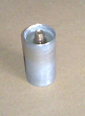

preloaded pneumatic cartridge
Sat Jan 16, 2010 2:33 am
maybe you should try and make a valve which can take alot more
Or I could keep the schrader and have it recessed as in my original design.
chinnerz
Posts: 470
Sat Jan 16, 2010 3:13 am
i was talking about the core
Sat Jan 16, 2010 3:23 am
chinnerz wrote:I was talking about the core
Not really worried about that :)
mega_swordman
Posts: 526
Sat Jan 16, 2010 4:33 am
chinnerz wrote:I don’t know how much abuse the Schrader valve can take, maybe you should try and make a valve which can take alot more
Although plausible, the problem I see would be keeping the homemade schrader down to the same size and still function as well as the original. It is possible, but it would be a tad bit difficult to construct.
Personally, I think all you need is some way to cover the outside of the schrader, that way it doesn't have the end sticking out. As for the mouth of the cartridge, shouldn't you be able a ring around either the inside or around the outside to help keep it in shape?

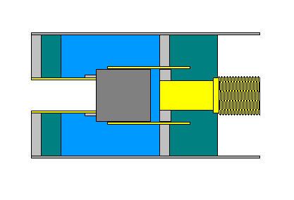

I really want there to be blowback potential so I'm making a new cartridge, 0.22" in a shorter but much wider (24mm O/D) body, giving it around 5 times the volume of my previous 0.22" cartridge. Also, the ratio between cartridge face area and calibre is 19:1, and at just 5 psi there will be a force of over 3lbs attempting to push the cart out of the breech.
The disadvantage is of course the more involved construction, which requires casting with marine epoxy and longer fabrication time, but if it works it will be worth it.

However I've been wondering. Why is it you always put the piston in a smaller tube and epoxy that into the chamber? Wouldn't it be simpler just to mAke the piston the diameter of the body?
chinnerz
Posts: 470
Sat Jan 16, 2010 9:37 am
i too wonder this, i think it may have something to do with reduced pilot area, and increased actual tank area, or that id will depressurise quicker
Sat Jan 16, 2010 9:41 am
JDP12 wrote:Why is it you always put the piston in a smaller tube and epoxy that into the chamber? Wouldn't it be simpler just to make the piston the diameter of the body?
Cutting solid rubber pistons with a sharpened tube is the quickest and easiest way to make them, which makes the method ideal for cartridges that have to be produced in quantity. However by definition I'm limited by the size of tube that fits in my drill, so if the chamber body is any bigger than half an inch or so I don't have this option.
