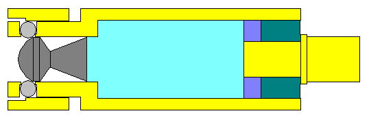

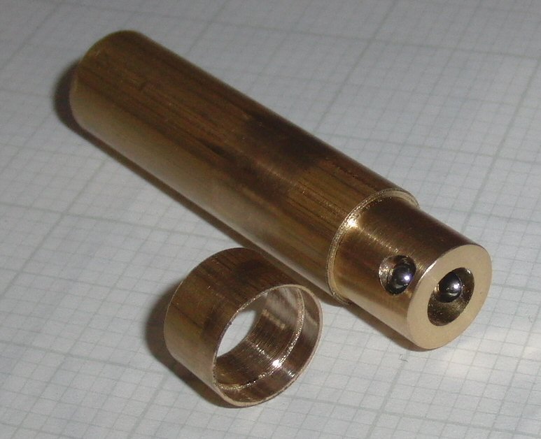

Having a play with a valveless preloaded cartridge, stuck a schrader in the back and waiting for it to cure.

Is that a triggered cartridge? also what's stopping air leaking passed the pellet.
Sun Jul 24, 2011 6:14 am
Crna Legija wrote:Is that a triggered cartridge?
Yep, push the collar back and bang! That's the theory at least.
Pressure inflates soft lead skirt and seals, like it had done here.

jackssmirkingrevenge wrote:Pressure inflates soft lead skirt and seals, like it had done here.
ahhh that makes it much simpler :lol:
Sun Jul 24, 2011 8:22 am
Here's the first tentative test at 50 psi. The issue here is that ideally, you should load the pellet head first and the skirt gets swaged down for a good seal, in this case loded skirt first it doesn't really work so I had to add a rubber disk to make it seal. This unfortunately added a bit of friction so it didn't fire immediately, in fact you can see me pulling away thinking it wasn't going to fire before the pellet pops out.

Here it is at 100 psi, looks promising enough to make a "proper" prototype and take it to higher pressures, maybe with moar balls for support, and perhaps some silicon tubing to improve sealing...
