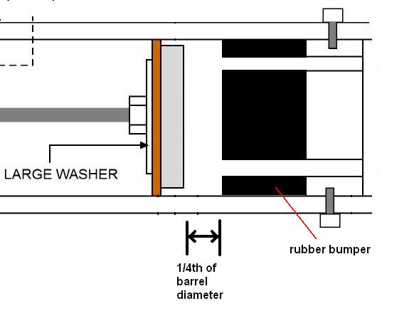

One problem I found Jack, if I call call you that. The first cannon I built without a spring, I had to charge the chamber first. Than I rammed the ammo down the barrel which had a tendency to push the piston back and fire the gun prematurely. With the spring the I can load first than inject the air. Seems much safer.

Politeness costs nothing and what's a forum for if not to help your fellow hobbyist? MrCrowley is just as nice a bloke but being a moderator is sometimes forced to to approach manners differently. I had seen your jeep cannon, i think I had commented on that thread :)
Also just to clarify, this is the modification I recommend for your design (though I'm sure you had already understood)
edit:
the difference in area between the piston and the calibre is about 0.44 square inches, this means that at 110 lbs of pressure there's a force of almost 50lbs keeping the piston shut by air pressure alone, so it would take a real lot of force to open it prematurely, still very safe in my book unless you use it at much lower pressures.
piston mod.JPG (23.62 KiB) Viewed 2737 times
