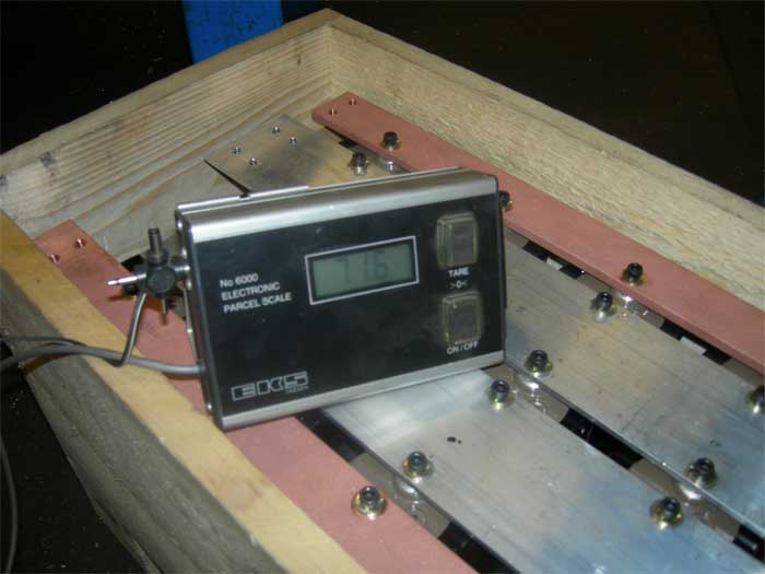

Thanks.
Next time i will take the scale with me and measure more exact how much aluminium i use.
I take the powder and wrap it in foil to keep it in place.
Normally i clean the chamber and barrel every time, but i think that you can get away with doing a few shots before cleaning.
Yes you could put all the caps it in parallel for lower ESR, and it will make it possible to get a higher current pulse.
But if you are discharging them into a load with a little higher resistance, then you can get higher current with the caps in serie/parallel and a higher voltage.
I can rearrange the capacitors in my bank to 0,36F 400V if i want, maybe i try that some day and see what gives the best results.
The current limiting resistor is used to limit the charge current so i'm not risking damaging the rectifiers.

clide wrote:What are the overall dimensions and weight of the capacitor bank?
The bank weight about 73Kg.
Tomorrow i will do some more shooting and try to determine the muzzlevelocity..
What do you think is the best way to do that on a ETG?
