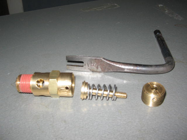

This is what I did to the pop off valve. First I drill out the hole thats on the side..I think its to keep the cap from being unscrewed.. Second I made a special tool so I can unscrew the cap.The rod thats inside this valve I threaded,but the one thats on my gun now is not. I just pinned on a bolt coupler to the rod and screwed on a hook bolt for the trigger. The spring in this photo is the original, but the one thats on my gun is way stiffer..I think you can get adjustiable pop off valves. They come with different springs..The tool is just a 3/8" or a 5/8" wood drill bit...I heated it up to get rid of the hardness of the steel so I can cut it..I cut a slot in the center so I can unscrew the cap around the rod..I hope Im explaining it correctly..Its kinda hard to explain things in writing. I think I can explain it better verblely..Also I am almost asleep..Its 2:00am here. As for making the barrel longer, I would ,but the brass pipe I got is kinda pricey$$$ Im going to trash the laser sight its garbage. I think Im going to make peep sights. I would think that would be good enough for sighting in. I'll post new pix of it when its done. :salute:
