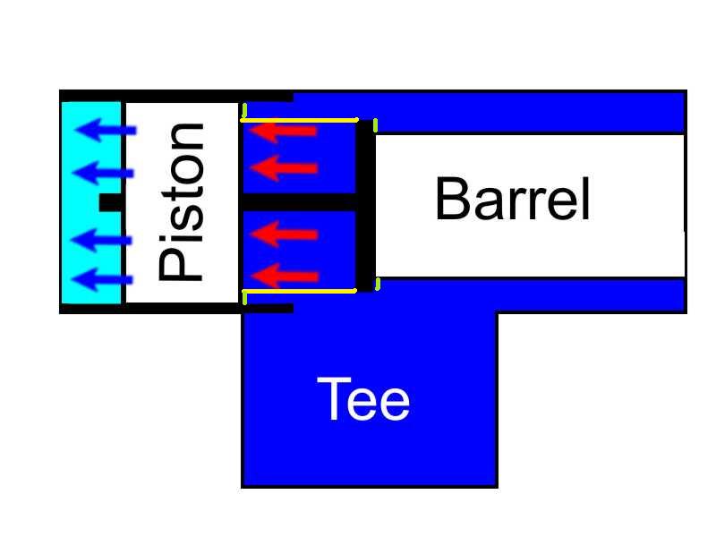

I hope you don't mind me butchering your diagram... but...
the back of the sealing face is being pushed by the same pressure as the area inside the two yellow lines... so the green lines show the only area where there will effectively be pressure acting backward when the piston is piloted.
looky
looky

Look ali the surface that pushes against the barrel is smaller than his piston surface and so the pressure on latter is smaller than the pressur ein the other direction!

When you look at the first diagram you can see the way the pressure goes
with a solid piston (red arrows). The air push against the side of the piston.
The other design has the advantage of a little more surface (piston surface -minus- sealing face) and a straight orientation in one direction.

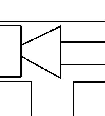

sputnick
Posts: 498
Location: Ontario Canada
Mon Feb 23, 2009 5:51 pm

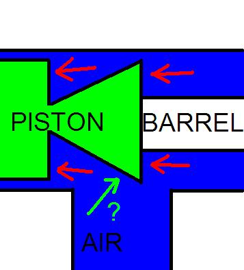

What about something like this...
would the change in angle affect it at all, since the force it not necesarily pushing it forward?
Just a thought.

EDIT @ Sputnick: No, because although the pressure is not pushing it forwards, there is now a larger area for it to act on (the area of the "cone" is higher than just a flat disk), which exactly cancels that out.

john bunsenburner wrote:Look ali the surface that pushes against the barrel is smaller than his piston surface and so the pressure on latter is smaller than the pressur ein the other direction!
yes thats correct... but the effective amount of surface useful for pushing the piston back is exactly the same as the solid piston because the area on the back of the sealing face cancels out an equal area on the main piston body, leaving the green areas in MY diagram, MRR hasn't placed them correctly.
