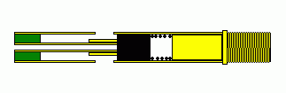

The logic is that air is coming out of the pilot schrader quicker than it can come in from the thin line from the main chamber, pressure in the pilot chamber will drop compared to that in the firing chamber et voila, just like any piston valve.

I think I'll give the pilot-feeding design a go, here at work I have fine stainless HPLC tubing rated for at least 5000 psi that should do the job nicely of pressurising the pilot chamber.

I started building the pilot-feeding design I drew up earlier but I'm not comfortable of feeding into the pilot because it smacks of the inefficiency I abhor. I was thinking of giving the original design another go, this time with a sort of "integrated valve unit" that fits into a single ported tube. This will allow a tiny pilot chamber that will reset quicker and a smaller diameter piston that will be much better supported. The only issue is the rather tiny 3mm porting, which is only 44% of the flow through a 0.177" barrel and just 30% of the flow through a 0.22" barrel.
I'll give it a go over the weekend, if it doesn't work it's cartridges FTW!

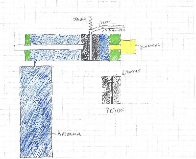

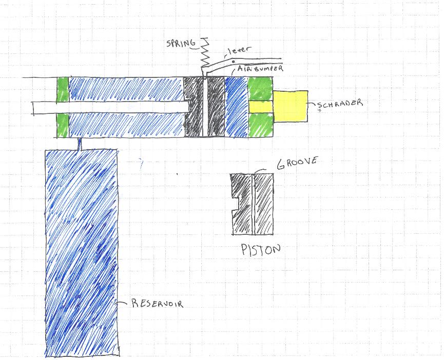

JSR- here is what I PMed you about.
Basically this is what I have come up with to make a full auto or semi auto gun.
It's a coaxial type design, only the pilot area is always full, acting as an air bumper. The idea is thus:
The reservoir is connected to the chamber, not the pilot. The piston seals against the barrel due to the PERMANENT air reservoir (bumper) behind the piston, and then the piston is held in place with a lever, which would go to a trigger mechanism.
The reservoir then fills the main chamber, and when I want to fire it, i simply pull the trigger, which releases the piston and is forced backward by the air in the chamber. It then automatically reseats due to the air behind it, which is not vented. The chamber then fills slowly enough to ensure that the piston reseats.
I put a little hole in the drawing of the piston, and i think it may have to not only seal on the face but an airtight seal around the barrel as well- just may make it easier for the lever to grab the groove and not have to worry about it sealing.
I'm not sure of exact numbers right now, but I'm in the midst of calculations to figure out how much air at what pressure needs to be behind the piston, what pressure will force it back, all those things.
So those will come in a couple days, but thats the basic design. It'll basically be pulsing, controlled by me.
I know someone is going to say that i could just use a QEV and popoff and get almost the exact same effect, but that really only gives auto.
The advantages of this, as I see it are:
1) Semi and possibly Full-auto
2) Has the potential to be very compact
3) A mechanical release of the piston
Some disadvantages:
The biggest I see is the valve not staying open for very long, resulting in a small amount of the chamber getting dumped into the barrel, very inefficient.
However, as i said, I am doing a lot of calculations to figure all of this out and make it as efficient as possible. those will be up in a couple of days
What do you guys think? I won't be building this for a while as I'm pretty much dried up of money, but if I do get it to work I plan on incorporating it into a Tec-9 or MP9 design, with the magazine being a reservoir/ammo storage combined.
Of course if this doesn't work, I may say screw it and just work on a pneumatic cartridge like JSR

this is basically his design
the one that could be built by modding a QEV
the only difference is that yours uses a mechanical way of actuation while his relied on a valve between the tank and the valve
I never claimed this was some new and revolutionary idea. its basically a basic piston design, only using a mechanical actuation.
i know that. That's kind of the point. This allows for semi auto and full auto I believe. And is smaller than a QEV
The mechanical actuation makes it better I think.
As efficient? Probably not. But I still think its going to work.'
I'll clear something up- the schrader is to fill the air bumper and control how much air is in it.
