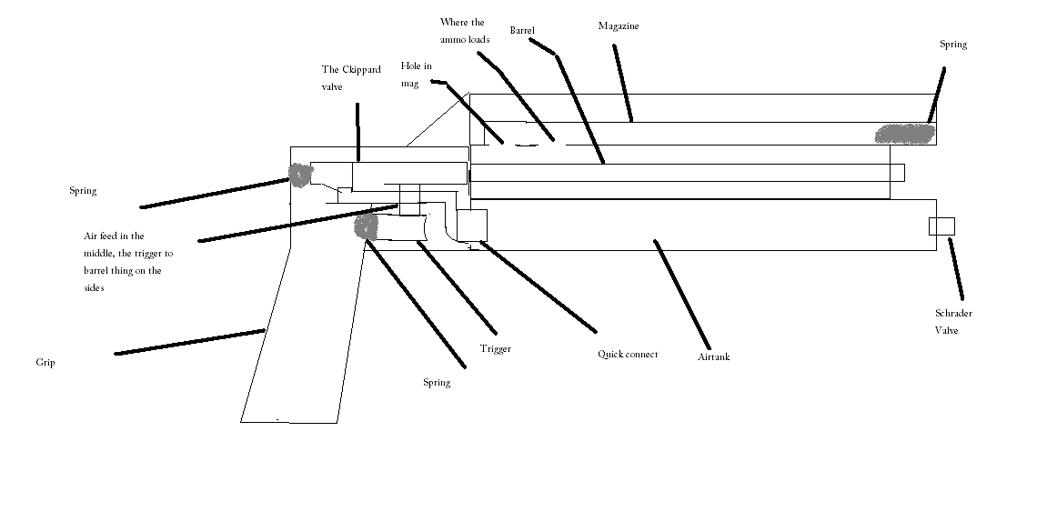

No, actually, I figured how to incorporate the valve into the barrel xD
And I'm on a 60 dollar budget, at my current estimations, barrel, air chamber and other materials will be around 45 dollars.
Also, biggest questions here, are annealed metal good or bad? Where can I find 0.6cm tubing for the barrel?(looked a McMaster, unsuitable) and where can I find some workable metal to build a body frame?
I'm also greeted with the main problem ( there aren't any more from what I can see), if I attach air tank to the gun, is there a way that I can manually open and close it? If I use quick connect there, air will already be feeding through to the neutral position of the clippard valve. Ex- when not firing, air is leaking because quick connect is always on I was thinking of how I can also connect the air tank to the feed when I pull the trigger, but I don't really see how that's going to work if I want my air tank to be detachable ( feature can be removed though, if one of you guys have an idea of how I can pull in and open air tank valve when trigger is pulled)
Heres a brief summary of how it works so JSR won't think I'm a noob xD
Air tank is hooked up to a feed. Valve is in neutral position. When trigger is pulled, it pulls the valve to firing position and air floods the barrel. When barrel is pulled back, magazine also loads another round into barrel( I forgot to draw an O ring there, but there's one behind and in front of where the round would be). Spring will spring valve+barrel+trigger to neutral. If trigger is held, auto fire will ensue.
From what I see, my biggest concern( besides the problem with the airtank) isn't skills, its the ability for me to get the materials

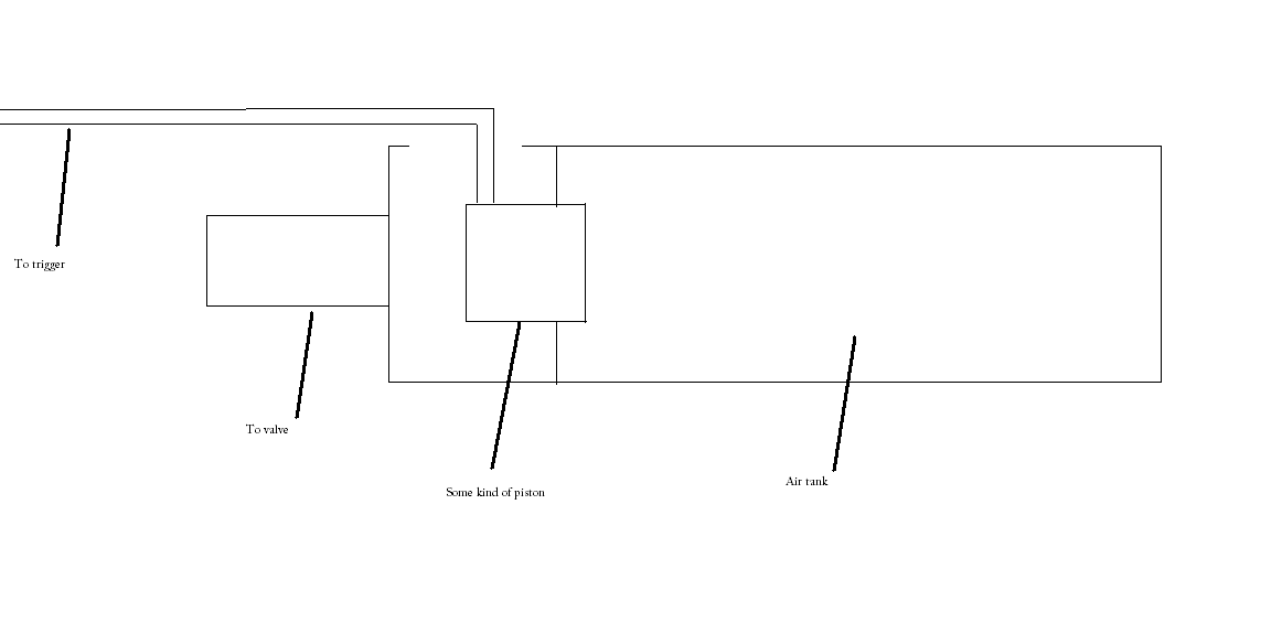

Any help on controlling the airtank? Quick question when I convert 0.6 CM to inches, it says 0.23622, rounding up is 0.243, but reverse converting only equals to about 5.99999 mms
Will this work?:
Mon Feb 14, 2011 9:48 pm
you want to move the barrel which is a relatively heavy part. No offence, but it just isn't the best idea.
nadjatee1996
Posts: 185
Joined: Mon Jan 03, 2011 7:20 pm
Mon Feb 14, 2011 9:58 pm
I'll figure it out, but will the air tank work if I use a piston like that?

you new to draw better designs idk wtf is going on in that one and are you going to use a 3way and qev or a blowgun?

I designed my own valve..I believe its similar to a Clippard valve

So you want to use a direct acting valve right ? one that switches as fast as you can pull the trigger right ?? well, it isn't the best idea - performance will suck
Personally I think you should just get a small QEV and MJVO-3. That's a foolproof design - you can't fu** it up even if you try really really hard
Not that experimenting is a bad thing but if you invest a lot of time and $ in your design and in the end you won't be satisfied with the result

Mon Feb 14, 2011 10:51 pm
http://www.clippard.com/store/display_d ... sku=MJVO-3
It's a pretty cool 3way valve - cheap and has good flow. I wish I could get it in europe for the price you can get it in the US

POLAND_SPUD wrote:you want to move the barrel which is a relatively heavy part. No offence, but it just isn't the best idea.
Still, it's been used succesfully before. In the case of the Anics A-3000, the barrel is in effect the hammer (which explains the agricultural trigger :roll:)
As to a barrel, airsoft barrels aren't that expensive, but if you find a model or hobby shop that sells brass and aluminium tubing you will find it cheaper.
