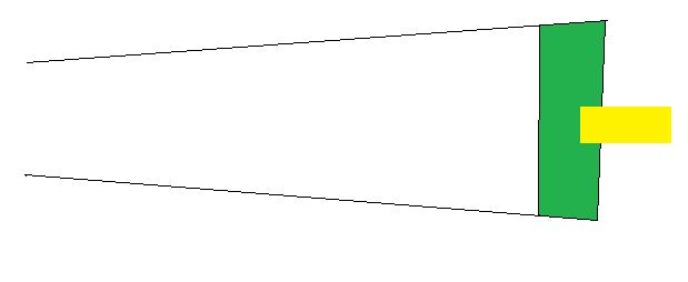

im having trouble with my new one, the external pipe tapers slightly, bigger at the front and smaller towards the filling plug, its making it uber hard to seal.

i was think about the too you could use a peace of string from the fill valve to the knife to hold have the mix pressure. well really if i can get this cunt to seal i can drill a hole in the epoxy plug and insert a second electrode for a spark gap.
this is what the pipe is doing not quite has bad tho

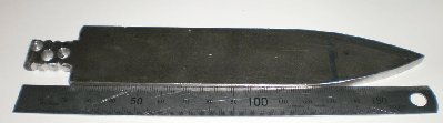

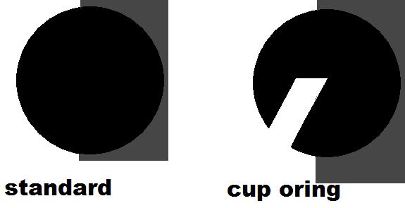

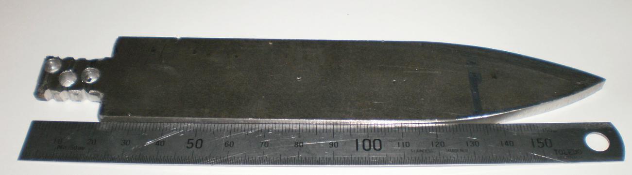

I fixed the leak by making a cup O-ring, and good lord was it a PITA to make. Tested it with very suprizing results, at only a 100psi the blade flew 20 meters and went over to see the neighbours yard. Jumped over only to find the blade broke, not too surprised it was only a hack saw blade. i will be making a new one it will look more like the real ones blade with out the groves in the middle.
edit: made the new blade, haven't sharpened it or tried to harden it, but with my reading look like it wont harden very well, since its mild steel.

Nice new blade! I am going to keep mine just a simple plugged up connecter, just to make it legal here. Other wise if I add a blade, its illegal, and I wont be able to use it. But really? 100psi and 20m?!

warhead052 wrote:Nice new blade! I am going to keep mine just a simple plugged up connecter, just to make it legal here. Other wise if I add a blade, its illegal, and I wont be able to use it. But really? 100psi and 20m?!
im pretty sure its not illegal to have one in here too but ill risk it, lol i miss typed it was 10m not 20 lol need to proof read.
