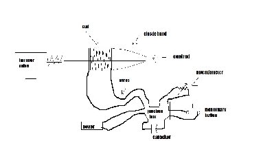

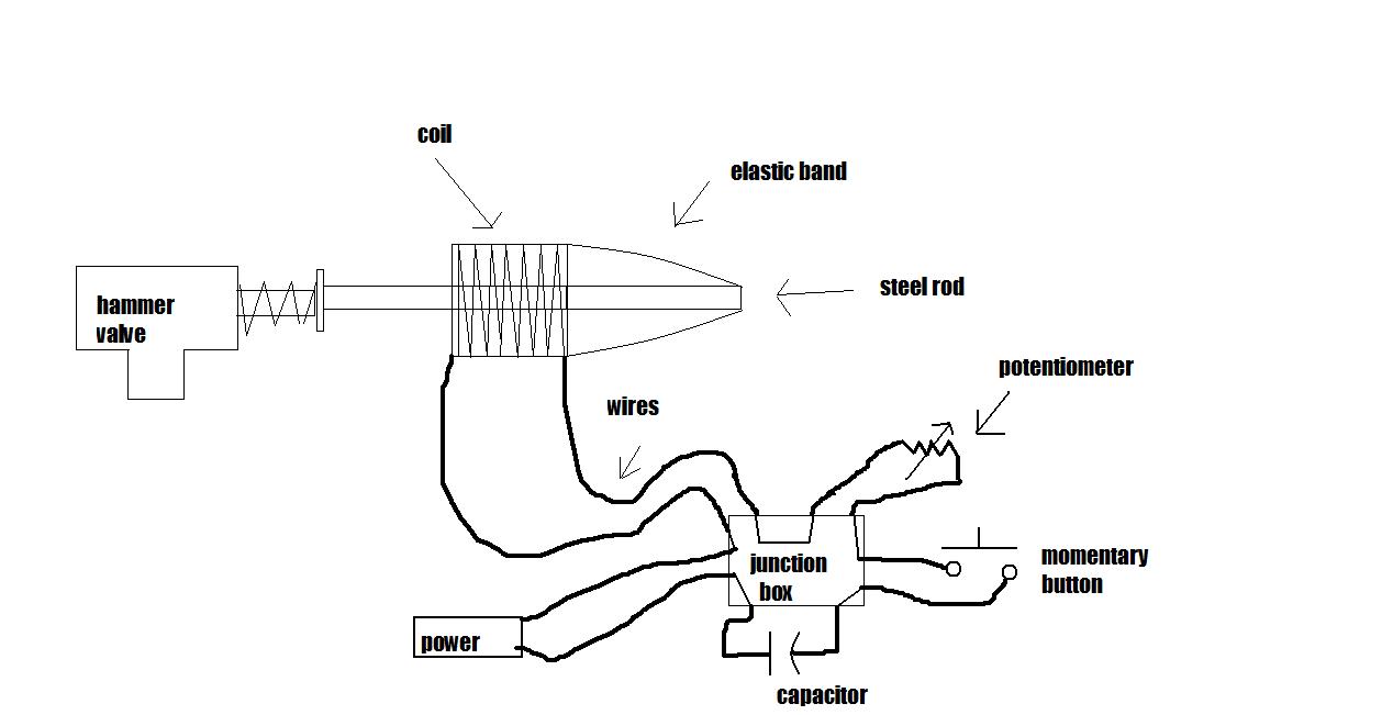

make your own coil with ajustable ROF not sure if my circuit is correct but you get the idea. :D

I have thought about making my own coil, but considering with the battery I'm going to use it has to be made with very thin coil, with the size of the coil in mind it would be a hell of work to make a proper one. I'm now try to see if it's possible make a serviceable hammer for the solenoid. Thx for the circuit btw, even though I don't know if it works, but it's a start point at least :)

could you wrap insulated copper wire or magnet-wire around a reel thats used for holding thread for sewing and discharge a capacitor through it like a coilgun but instead of using the coil gun to shoot projectiles, shoot a rod into the hammer like a solenoid
http://en.wikipedia.org/wiki/Coilgun

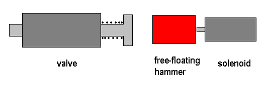

I though the idea was that the solenoid hits a hammer that is not actually attached to it?

Jack if the hammer is float, I need a low friction travel base to hold the hammer, but even if the friction is really low, the small amount of power the solenoid gives (0.8 N) still going to be wast quite a lot

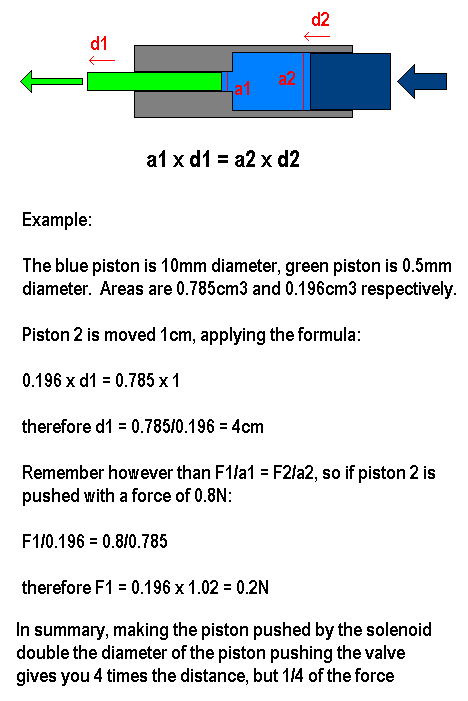

Travel can be mechanically amplified...
