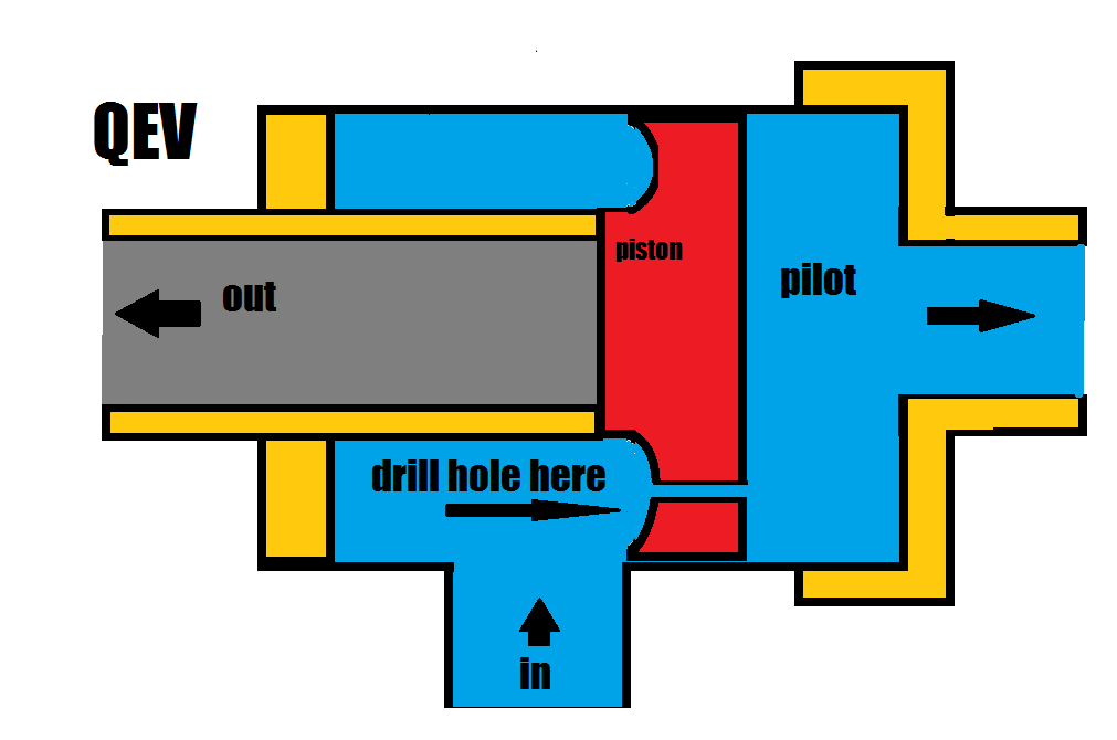

I don't understand the question..Can you explain the hold in the cylinder a little more, maybe add a picture or something. I just got the exact valve in the mail today and I'm interested in making the modification. Thanks

I misspelled the word "hole." I spelled "hold" by accident. On 8-8-12 at 15:52 you said to punch or drill a small hole in the piston of the qev. I didn't understand what you meant, where you meant, or what it is for. I'm just starting out with a qev myself and would like to make any modification that would help the gun. Thanks for your help.

Don't puncture the middle part where it seals the out-port and don't get to close to the edge of the piston as it might tear by the repeated stress of firing.
It's that simple.
Air coming from the reservoir will repressurise the pilot area as soon as the pilotvalve is closed and the piston will be pushed back against the port and seal again.
Now..if you want to pressurise the gun ( pump, compressor,whatever)
directly into the reservoir( wich can't be done with an unmodded qev), you need to put a weak spring behind the piston or it will get blown open by the incoming air.
So a spring will enable you to fill "chamberside".
This will help reduce the numer of fittings on the pilotside.
less bulk and smaller pilotvolume wich helps performance.
The hole is what makes the valve able to "repeat".
If that hole becomes too large it will hurt performace as the air just rushes out the pilot through that hole.
Keep it small!!
about 2mm should work..
It's that simple.
Keep it small!!

It you then use JUST a safety pop-off valve as a pilotvalve ( nothing more!!) and fill the chamber at high pressure and high flow and you get this:
( and build the blowback system to feed ammo offcourse)
Notice all I have to do is squeeze a blowgun to feed pressure into the chamber...and off she goes..
