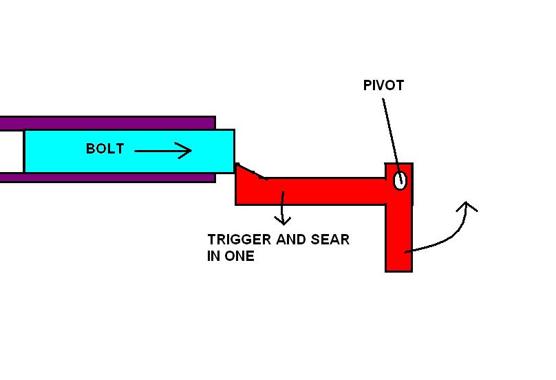

The sear could be improved to withstand more force, yet still function smootly and effortlessly.You could use that force to either operate at higher pressures, or make the valve open faster.

Here's my idea ( used it in crossbows in a different way)
- sear.JPG (22.65 KiB) Viewed 9878 times

I think the sear I have now will work fine for my purposes. But I'll certainly keep that sear in mind because it will hold more force.

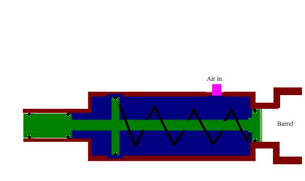

I just sketched a tee version of your valve, I find it easier to understand and make this way, and it has some resemblance of my inside out sleeve valve design only with a larger area in the back and a trigger release
I forgot to draw the air input

iknowmy3tables that design would work, but without the large middle piston it will have to be manually reset each time.

If you want full auto you will need to make a few changes.
This design ( see pic) has the larger surface area on the barrel side.
I
Pro's- valve snaps open once it reached critical pressure ( firing controlled by inlet valve)
Because of pressure drop in reservoir, while the "pilot"or, the pressure trapped behind the piston pushes it open like a regular piston valve.
Con's- No semi, most likely need more tuning to stop the entire reservoir from dumping( depends on spring)
Oh I forgot, the middle piston should have NO O-rings, just a snug fit, with "some" room for air to leak past it.
It might be nessesary to bleed the "pilot"at the point where the valve is at full opening, to get better performance.Could be achieved by a port in the back end of the piston assembly.
I
