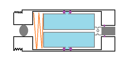

Fri Feb 22, 2019 10:45 am
Very interesting, and a class of this technology for which we do not know everything. I'm going to try some of these cartridges. I like them a lot and it's a matter of looking for the form without needing complex machines.
I've thought about doing something like that. It is quite simple to build.
The central duct of the air tank, is to level the pressure on both sides of the moving air chamber. It is to prevent it from closing itself by increasing the pressure on the left side where the ammunition is.
To recharge the cartridge with air, the accessory that introduces the compressed air must be screwed into the tip, tighten the firing pin and let the air pass. Once the pressure is programmed, the rod is released and the spring seals the outlets of the air chamber.
It should be very simple to open because the pressures are balanced. forever.

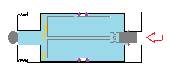

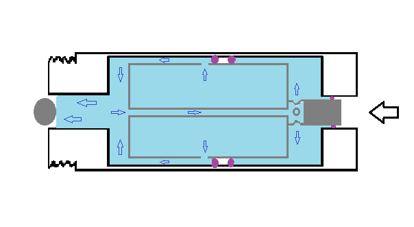

Sun Feb 24, 2019 12:18 am
I tried an animation, we'll see if it comes out correctly :?

Sun Feb 24, 2019 4:17 am
Interesting, my only concern is that since the o-rings have a large diameter, even though they are balanced there will be considerable friction at higher pressures so a larger force will be needed to actuate the cartridge.

Sun Feb 24, 2019 8:11 am
jackssmirkingrevenge wrote:Interesting, my only concern is that since the o-rings have a large diameter, even though they are balanced there will be considerable friction at higher pressures so a larger force will be needed to actuate the cartridge.
Yes, it is probably as you say. I thought about using it at about 15 bar which is the most I can compress. Only in those conditions does it seem to me that it can work.

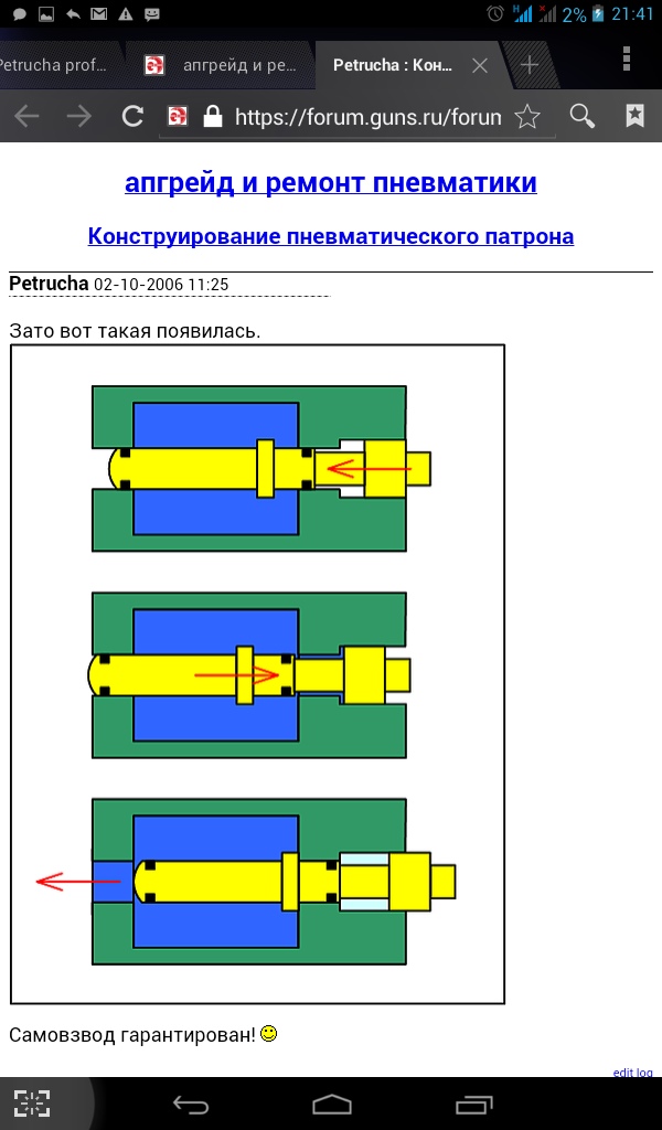

It will work very badly. When the hole passes over the sealing ring, the pressure will again move the cylinder with air back, all the air will not have time to get out. Better make a pneumatic cartridge with a piston valve, it is easier and 100% working.

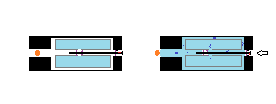

Sun Feb 24, 2019 1:48 pm
keks2033 wrote:
The central duct levels the pressure on both sides of the mobile air chamber.
To work at a moderate pressure can work.
Cartucho aire comprimido.png (4.32 KiB) Viewed 48717 times
keks2033
Russia
Posts: 94
Been thanked: 5 times
Sun Feb 24, 2019 4:06 pm
Try to make it better. At high pressure, it can break, but at low it should work well and for a long time.

Sun Feb 24, 2019 7:18 pm
keks2033 wrote:
I'm trying to understand your diagram.
Argentina
Posts: 1064
Location: Argentina
Has thanked: 274 times
Been thanked: 276 times
Sun Feb 24, 2019 8:06 pm
Maybe in this way it is not very hard to open. What I need is for it to be very simple to build. It is the same but with small o`ring.

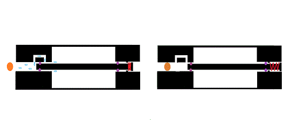

Mon Feb 25, 2019 4:17 am
hectmarr wrote:I'm trying to understand your diagram.
Here it is animated, the system is balanced at first, until the stepped piston is exposed letting the pressure pull it back:
Here is another variation where the pressure blows the piston forward:

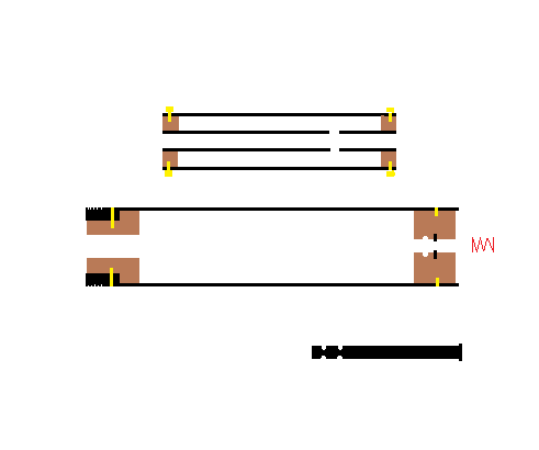

Mon Feb 25, 2019 11:37 am
This is the way to build the rudimentary little air cartridge. I need three tubes of different sizes, a three o`ring metal shaft and resin,and a small spring.
What is yellow, are the locks to reinforce the resin caps fixed to the tubes. In the small tube with the holes for air to escape, I will use small bolts to make room with the outer tube.
I'm looking at the size depending on the pressure I can make with my modified fridge compressor, a 200 psi.
On the front, a threaded part of those used in domestic, bronze gas connections is glued and secured.
It is to shoot bb`s of 1/4 "steel. :shock:

Tue Feb 26, 2019 7:53 am
What is the purpose of the inner chamber in your design? It seems like an unnecessary complication when it's the spool that's doing all the work, if I understood it correctly.

Tue Feb 26, 2019 8:40 am
It's just to make construction possible for me. It is necessary to have a station between the outer casing and the air chamber, through which the air can pass from the back to the front of the cartridge, and it is for this reason that I thought it could be like that. The small air chamber should not move.
