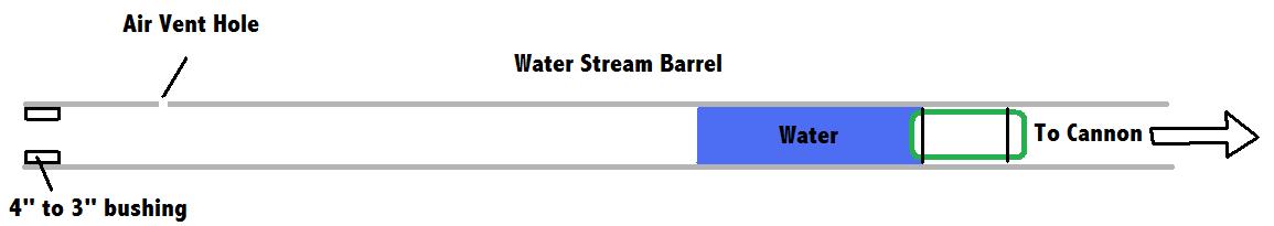

lol well i'll have to research how to fire a stream of water. it seems like i would be a little difficult because of the air from the cannon mixing with the water and just making a mist cloud.
maybe make a piston barrel?
- Piston Barrel
- WTB.jpg (20.76 KiB) Viewed 3548 times

Wow!!! Nice diagram, Lynyrd Skynyrd.
I was thinking just maybe foot long or so pipes clustered together lengthwise, (like a honeycomb sort of) at the end of the barrel like daxspudder suggested in the other post I quoted from.
I haven't tested it myself yet. Seemed interesting.
And of course the first water blast video on this cannon was the first I thought of.
If an internal piston was used like your diagram, the same type nozzle would still be worth testing.
Also IMO there should be more vent holes and further back to slow down the piston before it hits the end. Thanks. 8)

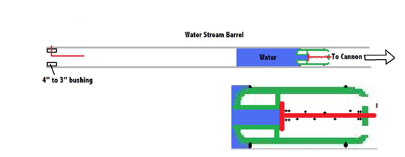

i was thinking about that, but i think the piston would slow down quite a bit from the compression from the water down to a 3" hole. I only put one vent in b/c if you start adding more, more water would be lost as it passes it.
I was also thinking of even eliminating the open air hole and putting a sprinkler there so instead of loosing water you just have to flip a switch and decompress the air from the barrel.
Or even inventing some sort of valve that is inside of the piston that will allow air to pass through once it reaches the end?
