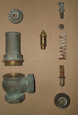

Yes, a brass 1" pop-off valve! I took it apart and it's got a bit of surface corrosion but it's to be expected given its years hooked up to a steam pump, but all it needs is a good clean et voila, I might just make that auto marble gun *muahahaha*
In case you're wondering, that tiny little thing in the middle is the 1/4" pop-off valve that's the original subject of this thread, for scale :)

Location: The Netherlands
*Whistle* Now that's a popoff!

psycix wrote:*Whistle* Now that's a popoff!
It certainly is :D needs some modding though to ensure it works like this though, but not much work. The important thing is that there is a strong body and spring that can deal with the larger areas involved, the rest is easy.
The seat is a full 1" diameter, meaning that 3/4" porting is just about right :) basically I'm going to fit a piston tube - 37mm, giving a piston:seat area ratio of more than 2:1 - to eliminate the dead space and cast a new lighter piston, going by the same principles as my other "rattlesnake" valves it should work a charm.
I'm not exactly sure what I'll be hooking it up to, but it will be big and it will need to be hooked up to a compressor :roll: :D
