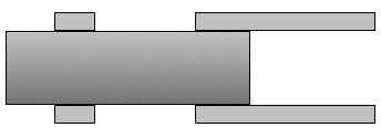

Hi, i made two new video yesteday, where i'm shooting 20mm diameter cylinder, and 6cm to long.
I'm limited to just over 200psi so i's not very very powerful yet...
Thu Jun 30, 2011 12:52 am
Nice, I would wrap tape around the other end too, it will be more stable in the barrel and probably come out stronger.
I'm not sure of your backstop is adequate, especially if there is something behind that hedge that might be vulnerable to pieces of steel flying around at silly speeds ;)

You're right, but i wanted to put le center of gravity (i don't know how tell it otherwise) forward of the projectile. I'll try ;)

Center of gravity is correct, actually. Placing the tape at the back of the projectile will help drag-stabilize it a little.

Mimikool wrote:You're right, but i wanted to put le center of gravity (i don't know how tell it otherwise) forward of the projectile. I'll try ;)
It's not stable as it is, try it as per the below diagram with a hollow tail made of wider tape.

I will however add that I made a projectile that looked quite like the one in the diagram, but it failed to stabilize and impacted sideways, breaking in half. The solid piece must be very short and the hollow region very much longer. Mine were about equal, as in the diagram.
