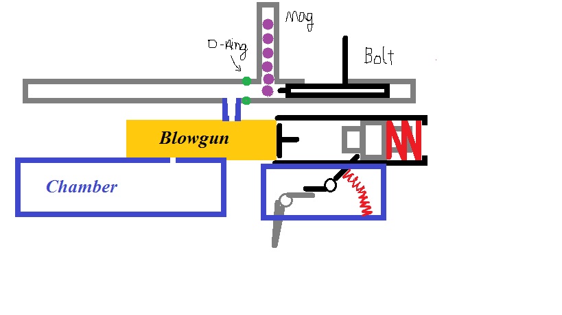

wyz, think you can draw up a diagram of how your trigger and hammer work?
try this and check his youtube channel becuase he has a pretty good hammer valve rifle :D
What I meant was more how does the entire thing function. Pretty much a cutaway of the entire trigger + hammer + impact point on the blowgun.

Ok here is a diagram, sorry about the painting, but I think you can understand it :wink: there is really nothing complicate at all.
(it´s not on scale)

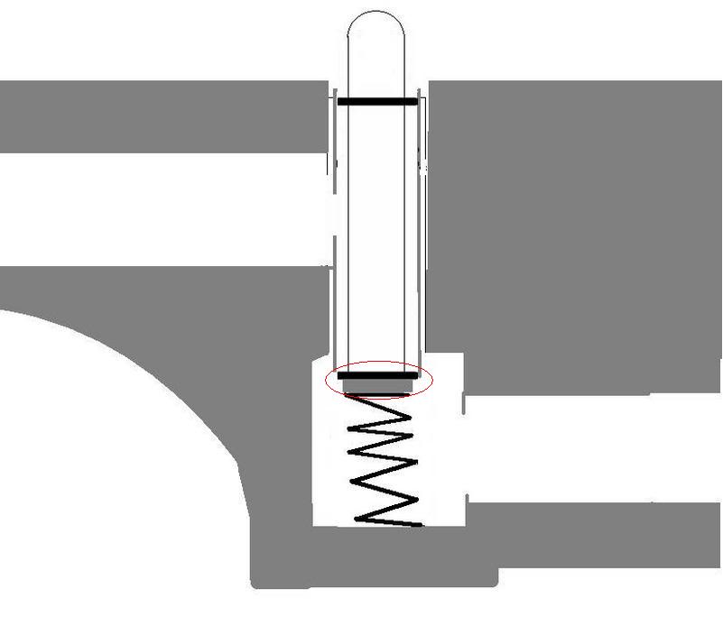

do you know the diameter of the valve part of the blow gun? like where the pressure acts? cheers
wyz2285
Austria
Posts: 2388
Location: Porto, Portugal
Thu Jul 28, 2011 4:47 am
:?: you mean the impact point between valve and the hammer? or the holes that the air pass though chamber to valve to barrel?
ilovefire
Posts: 511
Thu Jul 28, 2011 4:52 am
the diameter of the the valve core where the pressure acts
wyz2285
Austria
Posts: 2388
Thu Jul 28, 2011 4:58 am
8mm, you mean the part inside the valve that seales right?
Crna Legija
Posts: 2333
Location: australia
Thu Jul 28, 2011 5:06 am
i think he mean the part in the red in the pic below
yeah
yeah
wyz2285
Austria
Posts: 2388
Thu Jul 28, 2011 5:12 am
Ok that what I thought, yes that 8mm in dia :) good air flow actually
ilovefire
Posts: 511
Thu Jul 28, 2011 5:27 am
ah ok thanks, i think mine is about 10mm, wasnt sure if mine was to big for a decent sized spring/hammer to open, but i guess if you can get the 8mm one to work with twice the pressure i guess it shouldnt be to hard
