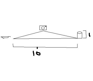

Um i calculated the speed to be 288.18 m/s or 945 fps.
You have to remember that the time it takes for the sound to travel from the target (10m away) to the microphone is 0.0303 seconds (speed of sound at 330m/s). So you subtract 0.0303 from 0.065 and you get 0.0347. So that is the true time it took to travel 10m (assuming that the microphone is held close to the gun).
Therefore 10 / 0.0347 = 288.18 m/s 945 fps (big difference to 504 fps)
Sorry to get all technical and stuff but remember that the speed of sound is quite slow so you must account for it to get an accurate measurement.

Whoa something in my head just clicked and it just occurred to me that 945 is SH*T fast. Well thats what i calculated using the diagram above, maybe it has been speed up. Or maybe it wasn't actually 10m.
Maybe someone should re calculate it because im quite tired at the moment, i could have easily made a mistake.

The audio file was recorded one metre to the left of the exact middle point inbetween me and the target. I have also factored in the speed of sound into my equation. the round thing being the barrel(target)
Here is a person that has acctually tested wadding vs rifling
look towards the bottom of the page in a secton called "final accuracy" and "rifling the barrel"
http://www.sentex.net/~mwandel/cannon/air_gun.html
