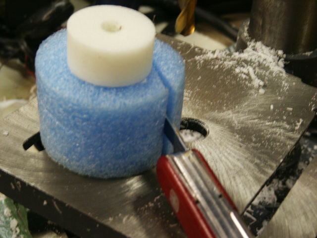

mobile chernobyl wrote:What type of bumper are you using? I've put alot more stress on that in my designs after a faulty bumper design caused a catastrophic failure on a 4" coaxal I had allowing the piston to shoot out the back of the gun.
The piston design I will be using is good amount different from your's however and I'm not too worried about cracking. I'll post a pic of it when completed.
Closed cell swim noodle. I wasn't too worried about cracking either. I thought my first was a manufacturing defect, the second, was a concern, the third a indicated a bad trend, and the forth was the last straw. I even babyed the last one and ran on reduced pressure, but it still failed. It didn't blow out the center the last time.
It's time for new material.

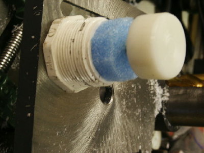

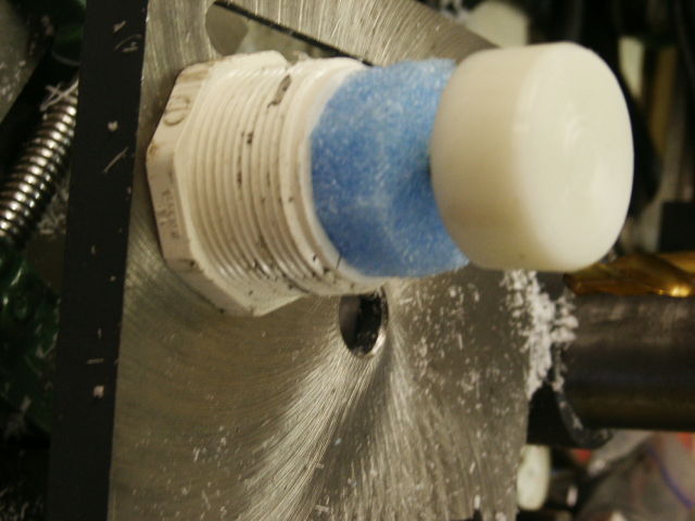

On the replacement of the Mouse Musket, I went to a QDV configuration and again used a swim noodle for the bumper as shown.
Parts of the breech, piston, bumper, pipe plug.  Blowgun trigger not yet attached.
Cutting diameter of bumper down to size.
Bumper assy can be seen in the replacement for the Mouse Musket after a coupling failure.  PVC is brittle.  This is the Marshmallow Cannon.  Almost all PVC has been eliminated from high stress areas.

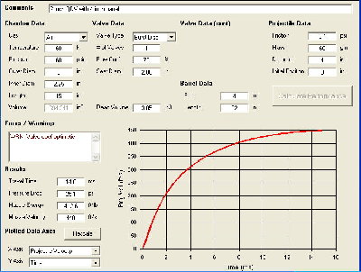

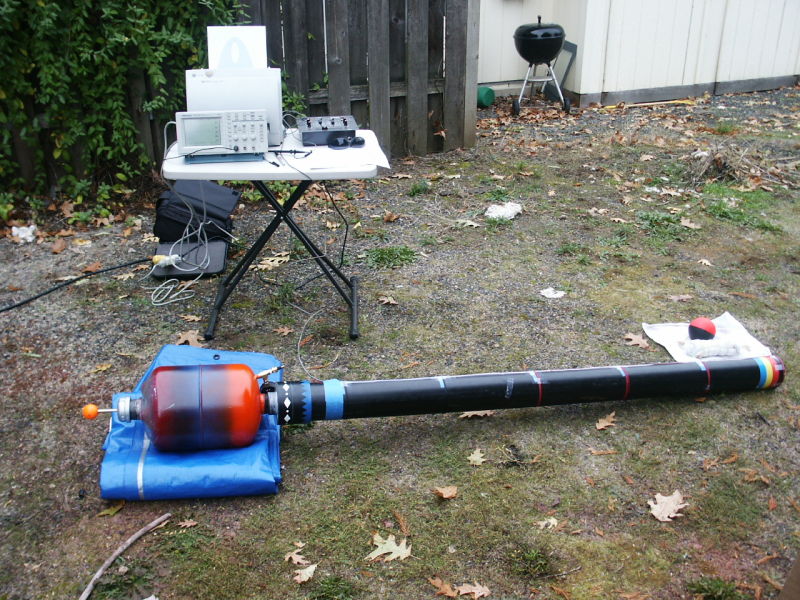

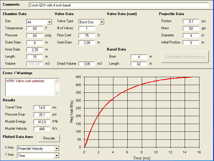

Do you have a copy of GGDT? (Gas Gun Design Tool). It is good for this type of calculation. On a 3 inch a pound is reasonable and yes the force is very high. It is why I went with a metal valve body in this 2 inch launcher.
Metal tank 2 inch valve cannon.  Test setup with 4 inch barrel and Poof foam ball.
Gas Gun Design tool attempting to match my performance graphs of the QDV t shirt cannon.
