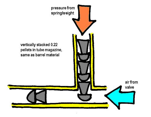

The magazine looks something like the attached diagram, and basically works on this principle
Since the one in the video is attached with tape and haemorrhages air like there's no tomorrow, the erratic behaviour is not surprising. I'm making a proper one now though, with the capacity for at least 30 pelletsand capable of being completely sealed. I'll see if I can get it to work as it is, if not some kind of blow-forward paddle/interrupter gear is in order, either way it's looking good :)

That is not a feed mechanism.
That is pushing pellets down a T piece.
jackssmirkingrevenge wrote:this principle
I wouldnt place my bets on that. If the spring strength is more powerful then the pressure, you'll get double (and triple and more) feeding.
Now you may say, the pressure is strong enough. But when the air is moving past at high speeds you know what happens: The effective pressure drops.
Shouldnt you go with spherical ammo? Easier to make.
Spudfiles steam group, join!
Wed Jan 28, 2009 12:55 pm
psycix wrote:If the spring strength is more powerful then the pressure, you'll get double (and triple and more) feeding.
Valid points, which is why I'm going to try it as it is tweaking the strength applied to the stack. If that doesn't work, I'll make an interrupter.
If I had a good supply of 6mm steel ammo, or 5.5mm lead balls, this would definitely be the route to take, however I don't have these options so pellets it is, as 6mm airsoft BBs aren't the best for damage and damage is what we want :)

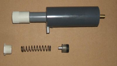

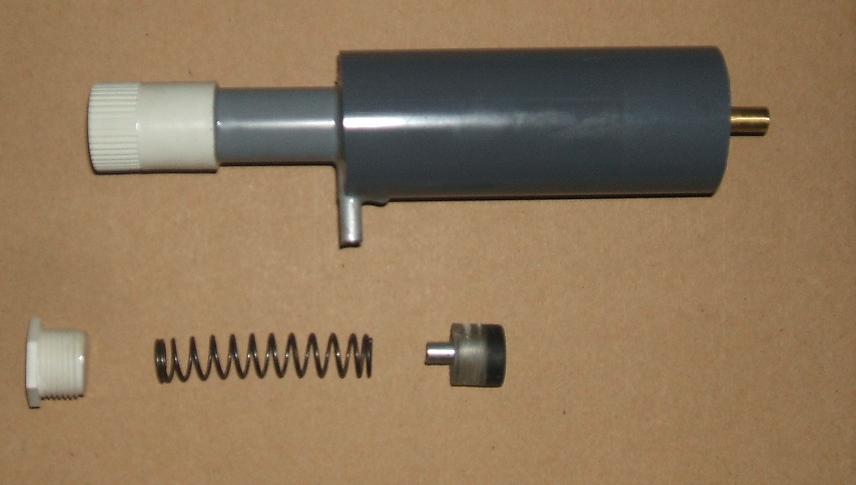

Introducing version 2.0 :)
Replaced the air spring with a coil spring, so the piston isn't 100% airtight but the (yes, psycix) threaded cap is so not a lot of air is wasted, and it's reasonably servicable ;) Seat and piston diameter are reduced compared to my previous prototype, we'll see how it goes tomorrow when it's fully hardened.

Good luck!
I have a feeling that it will work better without cap.
If you stop air from going out, the pressure on the back side of the piston will rise when air leaks past and especially if it moves back. Result: big force pushing the piston down.
If you are lucky, then this effect is beneficial and helps cycling in some way. If you are unlucky, well, it will not.
Join the threaded side... and then you will rule the empire of serviceability!
