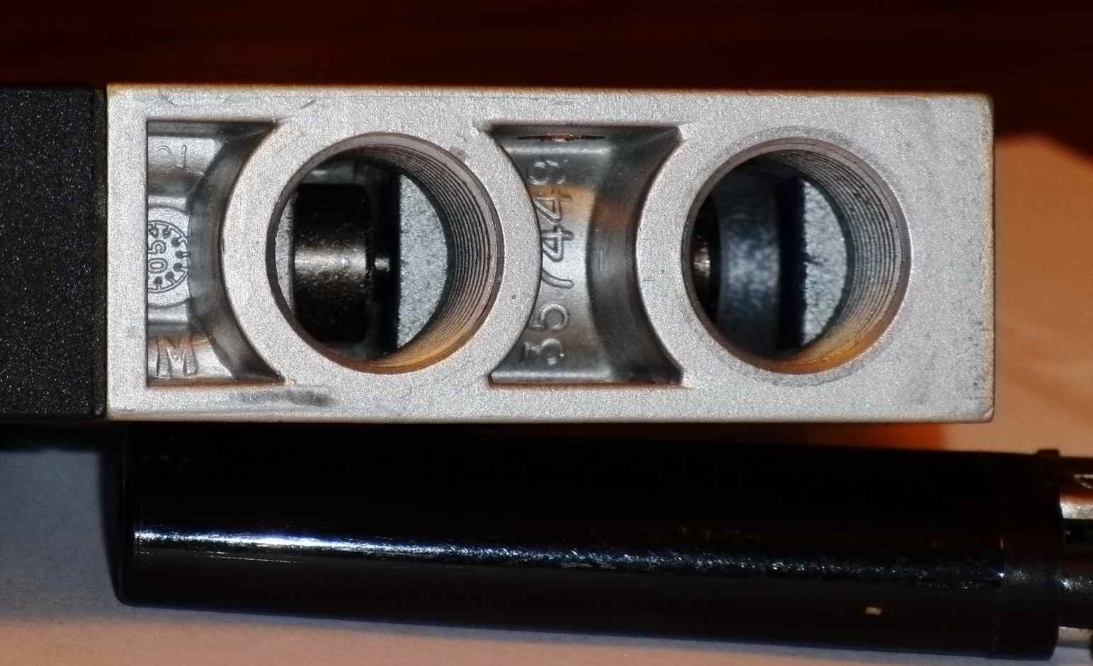

nice find... you should be able to use it as the main valve for a 6mm gunAs you can see in the diagram on it, it is a indirect acting, normally open valve, with 3/8 female ports, rated to 10bar and 2500 l/min flow-rate.
Probably up to 20bar- How much above 10bar can I go safely, without destroying the valve?

That might be the case because it is a indirect acting one, I assume yours is a direct acting one, because of that high power input.irisher wrote:my significantly smaller 3-way takes 25 watts so 1.5 seems a little low
Actually I want to use it with a 3/8 QEV, but that seems to be a bit overkill (which has not to be a bad thing...), for 6mm it should have plenty of flow.POLAND_SPUD wrote:you should be able to use it as the main valve for a 6mm gun
Maybe even enough for 9mm. I'm planing to test that, the difference in velocity between dcv+qev and dcv only with 9mm steel-balls.
That would be really great! Though I hoped it was machined out of one solid block of aluminium, but it turned out to be a cast piece...mhhhmmm...Probably up to 20bar

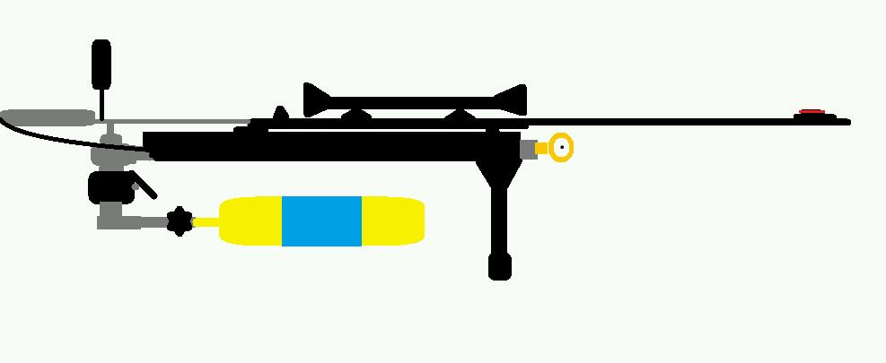

Why wouldn't I use a qev? I am trying to make a portable semi auto like http://www.spudfiles.com/forums/i-too-h ... t21039.htm
- semi auto plan-1.jpg (20.17 KiB) Viewed 56593 times

1/8" size would be ok (both the QEV and the DCV)
serioulsly though you need one that can extend fast enough and with enough force to feed the next round - if the air cylinder you've chosen isn't good enough then you need something else.... just caluculate shit and that's all
one that's ideal for your designwhat size air cylinder should I get
