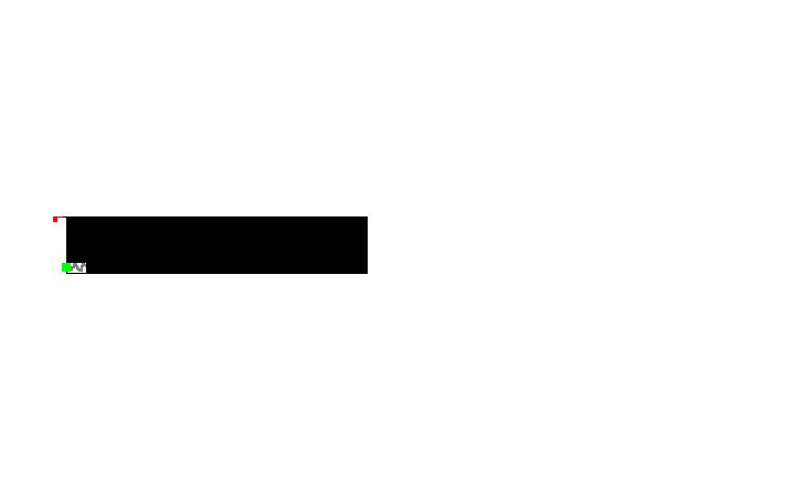

I can help with that. Ejector pins are easy, let me draw a quick diagram.
warhead052
- Staff Sergeant 3
- Posts: 1769
Here.
Pretty much what happens, is as the casing is pulled back, the ejector is applying pressure on the bottom of the casing, and the extractor is holding it in place until the casing has cleared the breech and hits the ejection port. In which part the ejection spring has enough tension to fling the casing out, and you push forward to load a new casing.
Its really crude, I know... Sorry.. But its the best I can do without a plug in drawing pad.JDP12 wrote:lookin forward to seeing it
- Green, ejector pin. Gray, ejector spring. Red, extractor.
- ejector.JPG (6.73 KiB) Viewed 3384 times

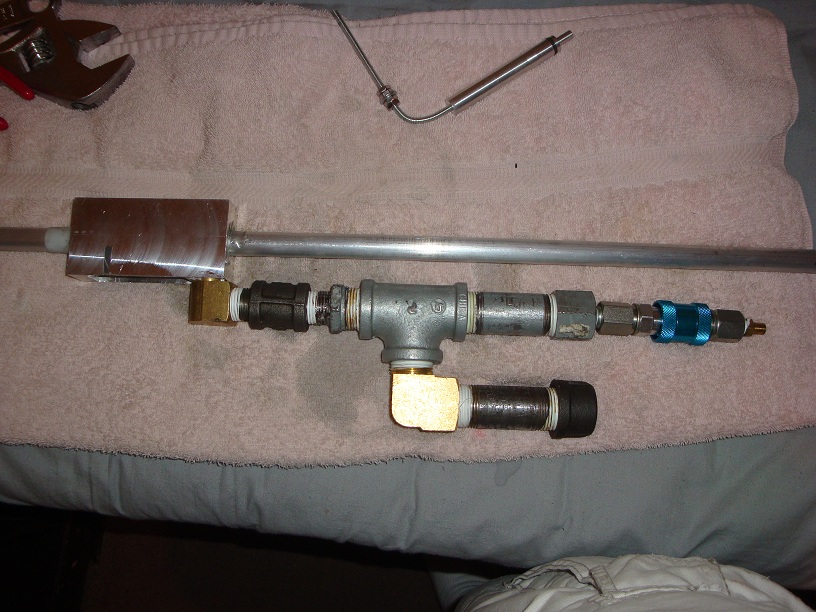

Update... got the sealing problems worked out, have to rotate the port to a specific place since it's not perfectly centered.. but it seals now.
Got the leaks all out except for 2, just gotta find my channel locks now to fix it.
Barrel's epoxied into the mag block, now I just have to work up a trigger mechanism, which oughta take a bit.
OK, I need some help. I'm trying to figure out how to compact this thing vertically. I'm going to be making a CBHV for it, but I like the power of a barrel sealing valve, so I want to have that option as well. So I'm looking for a way to compact the above picture vertically somehow. I can't figure anything out.
EDIT: I'm thinking about rotating it about the long part of the tee so the chamber is next to the barrel.. which would make it shorter, but a bit wider.
You could rotate the tee in the middle of your chamber such that the horizontal pipe coming off it rests against the barrel.
That's about all I've got.
Being at school sucks.. cuz I can't freaking work on this thing. Anyway, think I figured out my next move... Going to get rid of the whole barrel sealing valve as it sucks... gonna replace it with a toolies valve. That way its shortened by alot, will need a long activation rod, but no big deal.
Will be home in a couple weeks to work on this.
