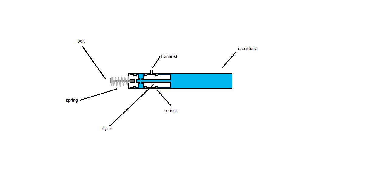

I use nylon as valve body, I don´t think it´s a solid platform for shear screws.

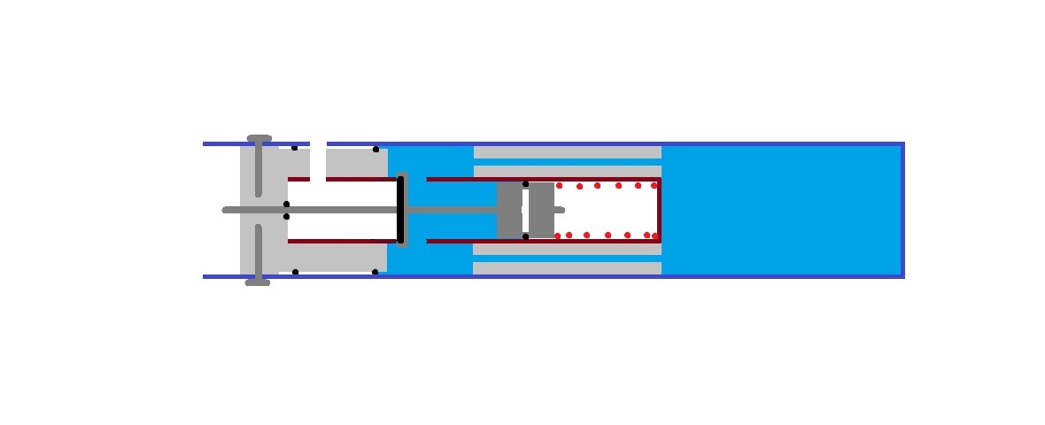

Update diagram: the seal has the same area as the counter piston housing, will it work?
- valve.jpg (31.76 KiB) Viewed 4479 times

You need to pay attention to the surface area upon which the pressure is acting...calculate the forces on the spool and compare them with the strength of the spring...is it gonna close?
I'm assuming your drawing is no longer to scale.
Nylon is a very poor choice for a material to be used thusly in a pcp... (Delrin/Acetal at a minimum) what pressure were you thinking about running it at??
Give serious thought to how you're going to secure the valve...it coming out like a bullet is a scenario you NEED to avoid. If you mention epoxy again...I'm outa here.
One suggestion would be to copy the design of the Crosman 160/QB78...place a steel ring behind the valve..(valve stem would be extended through this piece). With the valve making good contact and the piece secured to the tube appropriately, it'll take the load. Then one smallish screw to keep the valve itself indexed and yer good to go.
Piece I'm talking about is Prt#0200

Well I'm going secure the valve exactly the same way as I am doing now, take a look at the latest video I posted, it's working very well for now.
My drawing it's still in scale
well I will see if I can find a tube really slightly bigger than the spool housing, 1mm ID bigger...
Nylon is the only material I can get, and for now the only material I can work with my drill press.
I'm hoping I can use a soleniod to open this thing...

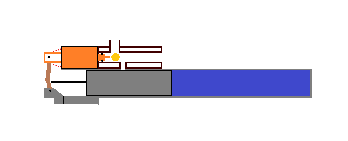

So IF I´m able to make the counter balanced hammer valve working, I´d like to make it a semi, or even full automatic, by using the solenoid to operate the valve.
The solenoid in normal conditions isn´t strong enough(12v DC), but I use a 250v 80uf capacitor to activate it, it gives a really strong, instant pull, just as a hammer
So, dear dewey-1, can you make me a circuit(hopefully not to complicate) that allows semi/full auto? without adjusting the fire rate, but uses a capacitor(anybody knows how big it should be? I think 64v 1000uf) to power the solenoid instead of 12v DC? Like this video shows, thank you very much
If full auto it´s too difficult, I´m fine with semi

Yes.Update diagram: the seal has the same area as the counter piston housing, will it work?
Oh and..
The surface areas are not equal.
One seals on the inside of the tube, the other on the face of it.
That tiny difference would make it just right.
You need a tiny difference to get a perfect seal and to make it snap shut after a burst.
I'm sorry if I was somehow unclear about how my version works but it seems you have accidentally copied the basic design.
I say go for it!!

Thank you sir!One seals on the inside of the tube, the other on the face of it.
So the area differential will be between the tube's OD and ID right?
I´m going to make it

Depending on the wall thickness of the tube ofcourse.
You would need about 1-2 mm difference in diameters.
get to work!!
get to work!!

The ID is 10.3mm, OD is 11.7mm
The difference is 1.4mm, area differential would be 19.3mm2, I hope it´s ok

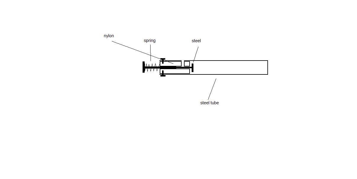

Goats spudz
- Specialist 4
- Posts: 458
- Joined: Tue Aug 02, 2011 12:31 pm
Will this work for 1000psi ?
- :P
- gun.jpg (23.74 KiB) Viewed 4287 times
Where's my Chuck key?

For me it will, but as Gippeto said, the o-rings will be blow out and worn out very quickly.

so a normal hammer valve with a nylon seal would be better?wyz2285 wrote:For me it will, but as Gippeto said, the o-rings will be blow out and worn out very quickly.
- there would be an o-ring around the thick stem
- ham vlv2.jpg (19.27 KiB) Viewed 4260 times

That wont work at all theirs a O-ring between the valve port and barrel port and the valve stem would get blown out.Goats spudz wrote:Will this work for 1000psi ?
