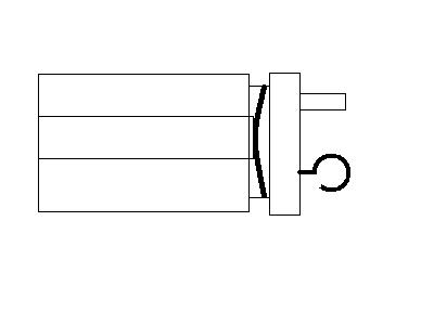

My grenade is done!
Except I need to go to Ace again to pick up some sheet rubber that's more flexible than the stuff I have now. It works, but the diaphragm flexes back only about 3/16."

I need a smaller hook with less threads. The grenade usually goes off when I'm about 2/3s done unscrewing the hook, which is about 3 seconds.
So the delay is good, I just need to put the hook in not as far, but then there's the chance of it getting shot out at me at 120 psi (that's no fun!).
I'll get a couple pics tomorrow, or sometime this week.

I was bored and thought I might as well make a diagram...
If you can't figure it out.....wow

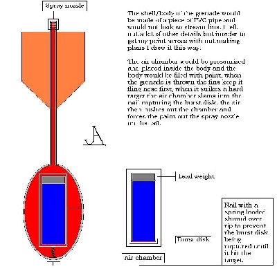

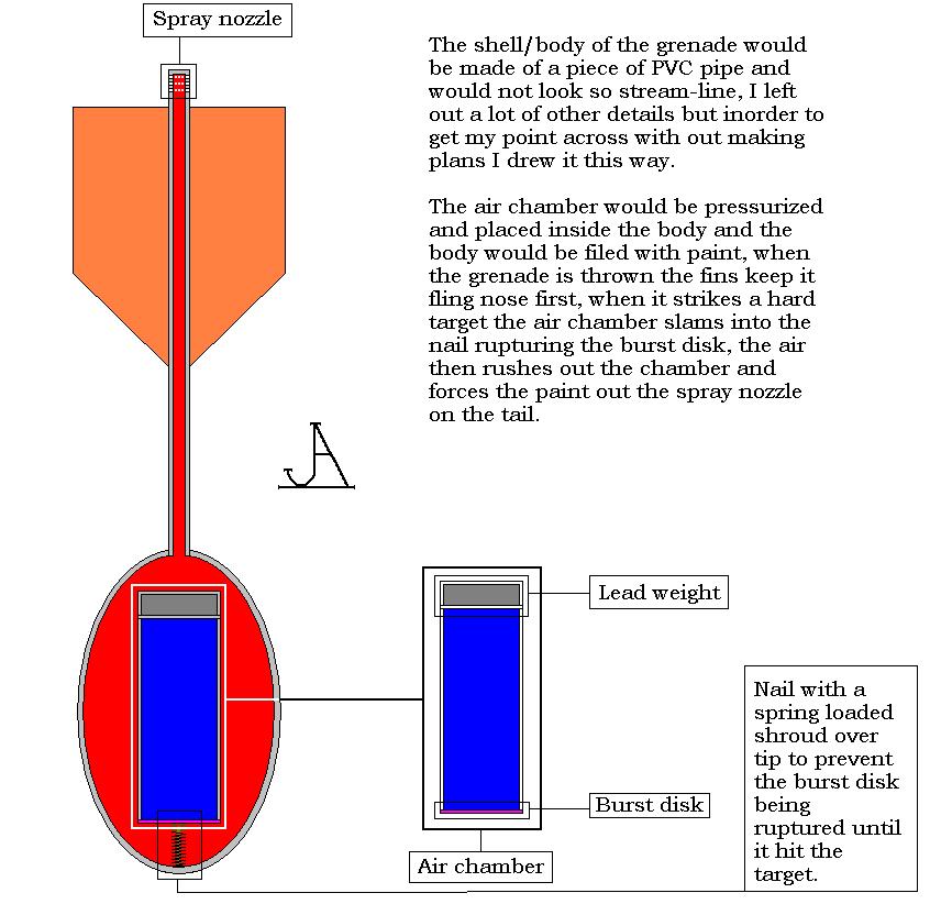

But here’s my design:
Ketcham's style paint granade

Good design also, but I think that type of grenade would be better suited to be fired from a grenade launcher. It would also be a much harder build (in my opinion).

As for my design, if I didn’t have so many other projects, i.e. my paintball long gun and my auto-cannon, I would make one, it’s not that complex. And it would work fine as both cannon round and hand grenade.
