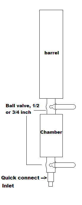

Ok, without reading every single post in this thread, Im going to give my advice.
At our school football games, there is a guy which we have named horn-man who has a t-shirt cannon that he fires across the field before games.
This is a quick drawing of his design. The dementions depend on your t-shirts and such.
I believe he uses sch 40 black iron and a large regulated CO2/N2 tank. If you can only get a compressor, make the chamber a bit larger to compensate for lower pressures.
Before I get flamed for an overly simple design, let me just say this:
Everyone here is complicating the project.
This is a gun designed to launch t-shirts. It doesnt need a modded sprinkler valve/high preformance chamber-seal piston/flux capacitor.
Even if you screw it up the first time, this design will cost so little you could probably make a dozen with $500.
- The pipe he uses for the barrel is probably 3" pvc, for the chamber 2-1/2" iron
- untitled.GIF (5.28 KiB) Viewed 3147 times

I need it to run off of co2, so tell be how to do that, with that design, and what are those 2 levers for? I need it to release so that it only releases a bit of the co2 so I can just shoot more off, I don't want to have to wait a few seconds for the chamber to fill, then fire off, just switch a one lever and it shoots out only so much co2.
I also want no levers, I want a trigger, like an airbrush for the trigger.
the "levers" are clearly labled ball valve because they are ball valves. it would work with that, but it would only be good for one shot.
you dont what ball valves, you want a sprinkler valve.

@hi: please explain why you think ball valves wont work.
Ok, heres how it works:
(you will need to buy a regulator for your co2 tanks)
Set the reg to the desired pressure, and attach the hose to the quick connect.
The two levers are part of the ball valves. look'em up if you havent seen one before.
Load a shirt down the muzzle
Open the first valve(the one by the inlet) and your chamber will be pressurized.
Then open the second valve. Put as much snap in your wrist as you can when opening, so the pressure is released into the barrel all at once.
Experiment and you will quickly find the best pressure to use to get an optimum power/number of shots ratio.
