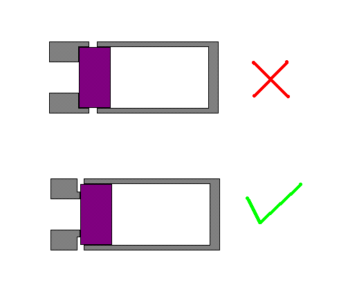

Is that....
a threaded cap?
Another one!!! I've seen another one on Jack's work!
You, sir, are getting better at this!

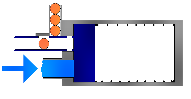

sniper hero wrote:about the pellet magazine, why not buy flat headed pellets and stack them horizontally?
They won't feed as well as round-nosed pellets
Also how big is this compared to the last valve?
The original version has a chamber made of the same grey PVC, so version 2.0 is only slightly shorter.
I have a feeling that it will work better without cap.
No it won't, the spring will fly out! :roll: :D
I see your point though, we'll see how it goes.

Hey if the wrts comes to the worst and air leaks past the piston filling the area behind, you can always drill a little hole in the threaded cap can't you?

I'm certain it will leak behind the piston, but fairly sure it won't be enough to affect performance. Ah well, leaving work in a couple of minutes so we'll know soon enough :)

Istn't it more the case that if it's sealed behind the piston if it leaks it could just vaguely fill with pressurised air , and so you'd have less piston travel with each shot till eventually you've got the same pressure either side?
Although of course if it leaks in, it'll leak out.

yada yada, turns out it'snot an issue :D

My first prototype was made from clear tubing so you can see it in action, the videos are on the first page of this thread:
Here is what it looked like inside:

One question: Is the valve on the side of the syringe, to fill the "air spring" at a predetermined pressure?
Do you regulate the frequency with the volume of the firing chamber ?, or with the air flow that enters this chamber?
I mean, higher volume, slower ?, or less air, slower?
Tue May 16, 2017 11:25 am
Yes, more pressure in the air spring = greater firing pressure = more power
A smaller "buffer" chamber will increase rate of fire, but air flow is the way to regulate it. You can see it in action here, I change the flow by changing the pressure on the blowgun trigger and this changes the rate.

I understand. You regulate the speed of the cycles with variation of the air flow. Good job Jack. The one who does not build an automatic and homemade airgun, after this, it is because he does not want to! :o regards
