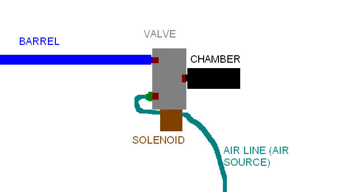

right now it doesn't really work like a hammer valve... the valve opens when the solenoid is energized and stays open as long as the button is pressed
that isn't very efficient - so it would be a good idea to use one 555 timer in monostable mode (press the trigger and the solenoid is energized, opens the valve, stays open for X miliseconds then closes)
then another one for full auto (where the other 555timer is in astable mode and its output triggers the first one)

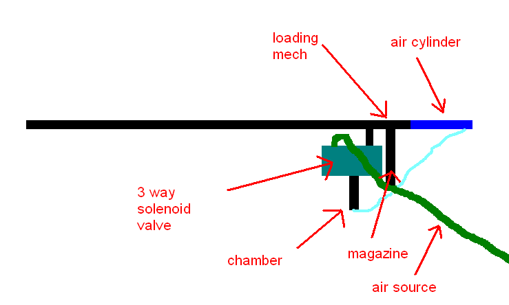

All in all I think you'd be better off if you buy one of those cheap 3 way 1/4" solenoid valves and air cylinder (or built your own)... You could build a simple 3 way + air cylinder combo but the 3 way valve would be the main valve too
you can worry about electronics later first you've got to get it to work right with a momentary switch
well in theory he could...cant you use a potentiometer and a pulse circuit so the lowest setting on the pot gives semi auto and when you turn it, it gives full auto
@wyz
- you could use this if you had an airsoft hopup unit... it wouldn't need an aircylinder
- 3wayasthemainvalve.PNG (11.04 KiB) Viewed 3356 times
- 3 way as the main valve.PNG (15.02 KiB) Viewed 3356 times

I already have the solenoid, I'm not going to change the hammer system. If you had watched the first diagram I posted, this valve includes reload mechanism, when opened, it pushs a bb
that's why I liked this particular valve for a full auto despite of the relative low air flow.

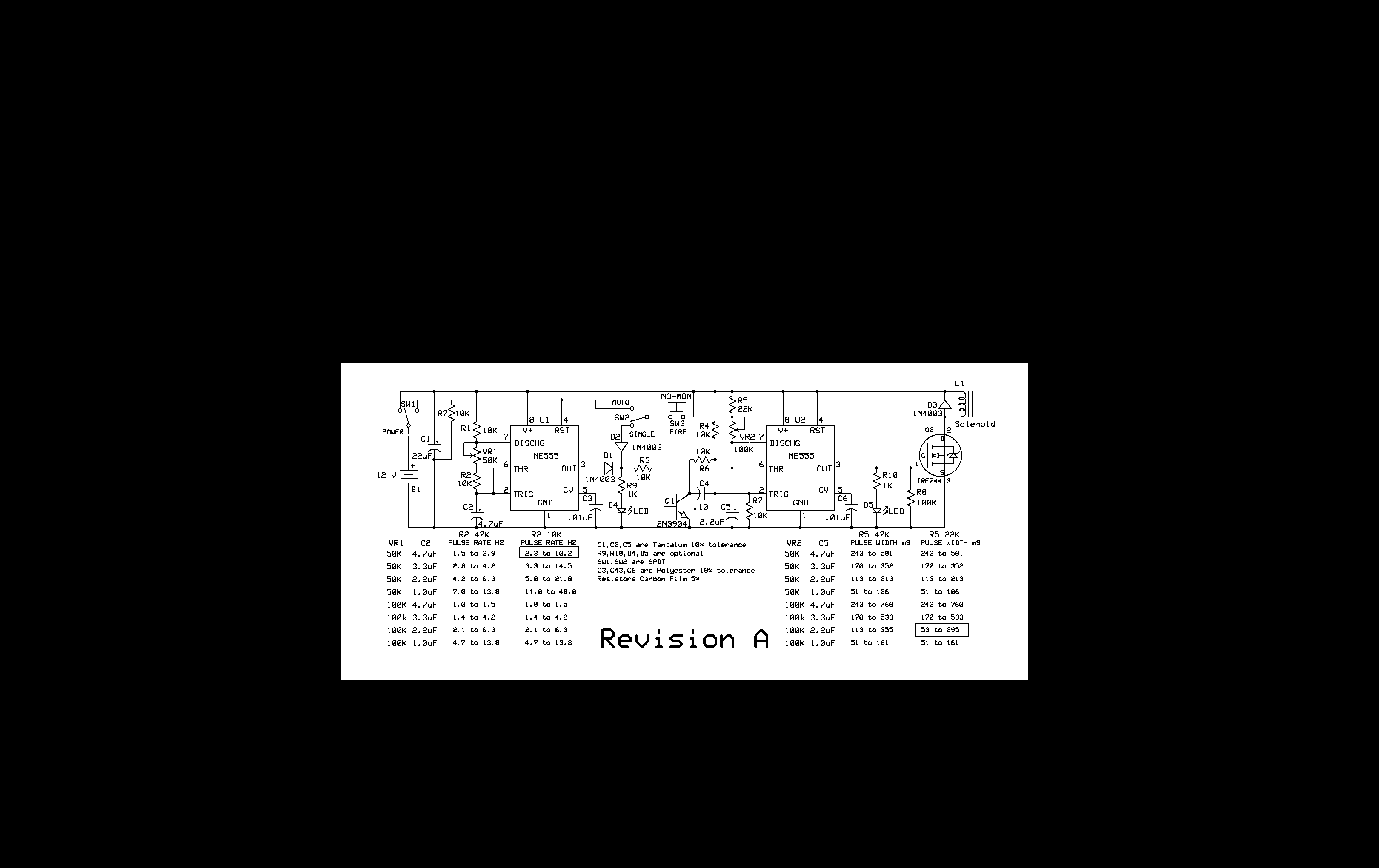

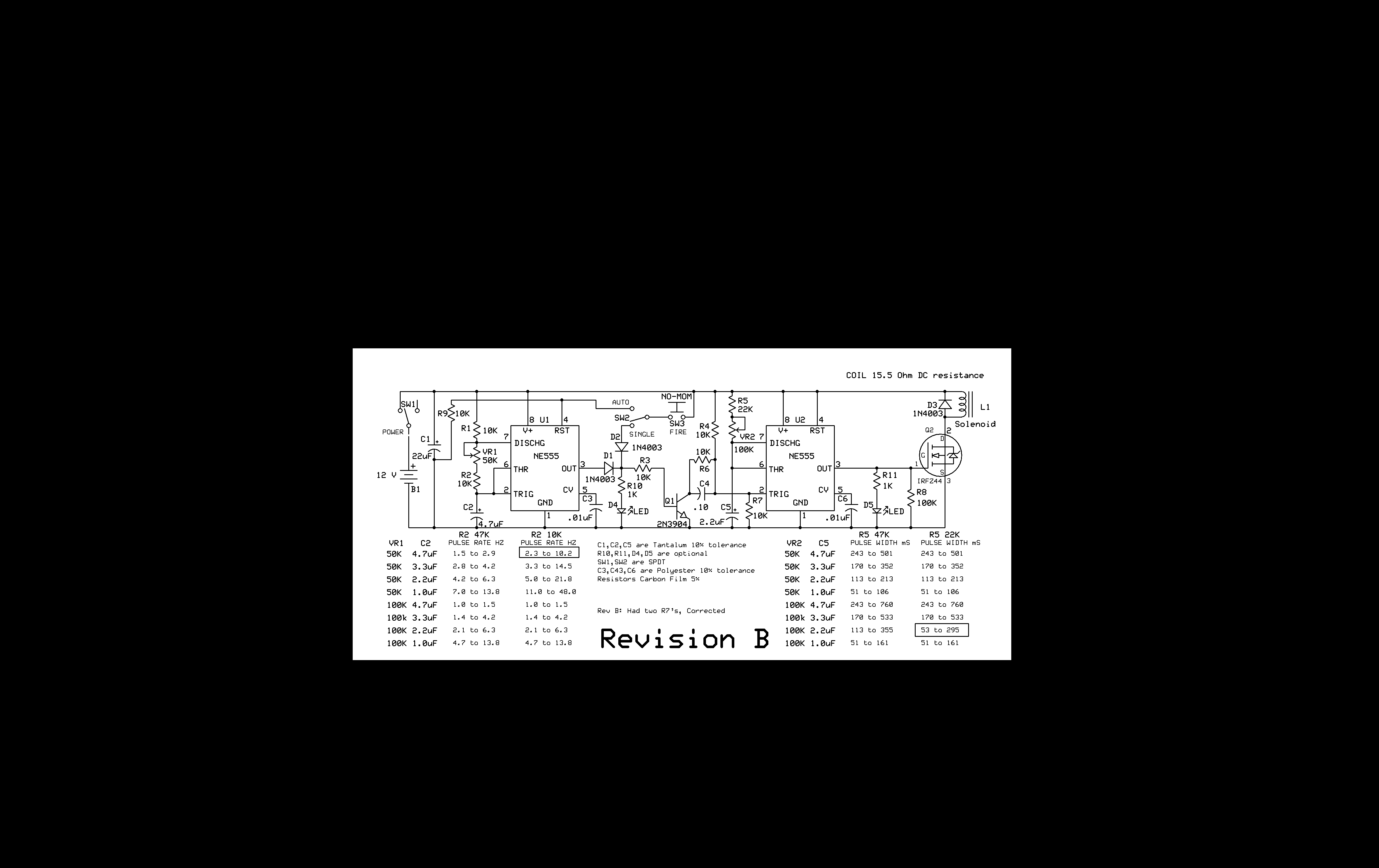

I have a preliminary schematic done.
Just have to double check and run a simulation. It uses 2 555 timers.
It has a true single shot mode and full auto mode.
The true single shot means if you hold the trigger, it will only fire once.
If you hold the trigger in Auto mode, it will fire continously based on the fire rate control.
You can adjust the pulse width rate for the solenoid so it will be the same for auto or a single shot. The auto mode can also be controlled for rate of fire.
edit 2: updated Rev B
edit: updated schematic to Rev A
Fire Rate: 2 to 10 times per second
Pulse Width: 53 mS to 295 mS
- 555-solenoid-circuit.png (19.86 KiB) Viewed 3190 times
- 555-solenoid-circuit.png (36.62 KiB) Viewed 3150 times

The true single option sounds like a semi, or after I pull the trigger, it shots once and I will have to open a switch to able to fire it again?
Thank you dewey-1, really, thank for doing this

i too agree that language is FUBAR but i think dewey-1 schematic is easierwyz2285 wrote:wow thank you very much guatz spudz!
Finally something that really helps me out![]()
Looks like I have to go to the electronic store again![]()
Damn the 555 circuit calculator isn´t in english or any language I know
Try this one. Much nicer to use.wyz2285 wrote:Damn the 555 circuit calculator isn´t in english or any language I know
http://freespace.virgin.net/matt.waite/ ... nouts/555/
The circuit that I have done has much better control and a true single shot compared to the other one.
The single shot mode requires that you release the trigger to fire again.
