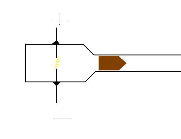

Could this schematic works?
Hotwired
Posts: 2599
Location: UK
Sat Mar 22, 2008 9:12 am
Yep thats the basic idea but the two terminals have to be insulated from the walls if they're made of metal.
Gunner
Posts: 111
Joined: Sun Oct 21, 2007 9:05 am
Sat Mar 22, 2008 9:24 am
But how close two terminals have to be if voltage is 800V?
DYI
First Sergeant 5
First Sergeant 5
Antigua & Barbuda
Posts: 2862
Location: Here and there
Sat Mar 22, 2008 9:35 am
Very close, if you're jumping an air gap. This works by passing current through a conductor, so the voltage doesn't have to be absurdly high.
Gunner
Posts: 111
Sat Mar 22, 2008 10:59 am
So is this gun based on it that the air between electrodes becomes to plasma and the so the pressure increases? And Larda uses aluminium powder that turn into plasma?Thanks!
