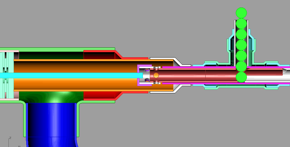

Here is how the loading mechanism works. It is connected to the piston valve with a threaded rod,, when the valve opens, the piston moves left and takes the bolt with it.
the advantage to this mechanism is reliability and mechanical simplicity - there is only one moving part. It's also always synchronized to the firing of the cannon. I have adjusted the mechanism so it will only admit a BB into the chamber when the gun is pressurized - the piston face compresses somewhat under pressure and moves the bolt just far enough to open the breech.
A potential disadvantage to this mechanism is the force with which the bolt is actuated - I've had it make marks in the plastic BBs when they got caught at the edge of the bolt, and my first bolt snapped when an alu BB got caught.
This mechanism can be used for other round ammo as well, IIRC someone built a marble gun using it a couple of years ago. I made this gun as a prof of concept for this loading mechanism.

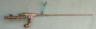

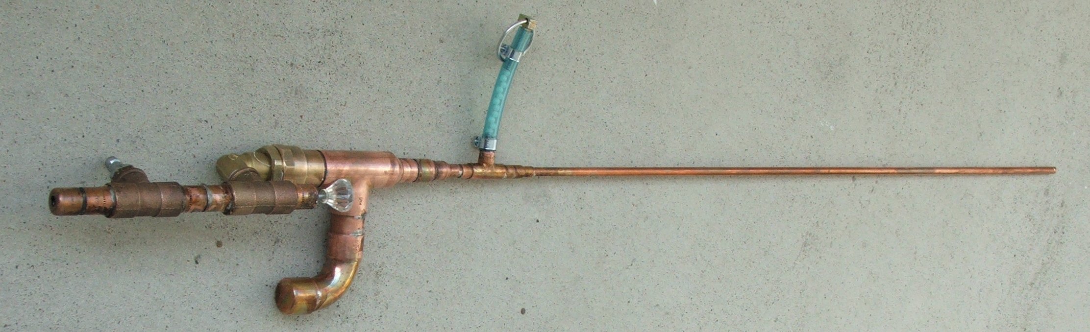

The semi airsoft gun, (almost) finished. It has a calculated chamber volume of 70 cc, and a barrel length of 90 cm. the barrel id is 6.4mm, so the fit isn't perfect, but it's good enough.

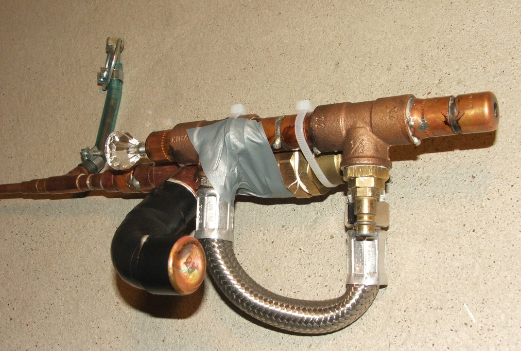

I changed around the mounting of the trigger valve so how it's more comfortable for left-handed firing. I also put a piece of copper pipe inside the magazine, to prevent the airsoft BBs from jamming.
This is a model of the internals of the valve, the piston can be seen to the very left.
