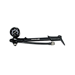

Maybe you could invest in a bicyle SHOCK PUMP. They are designed to reach pressures of over 300psi and are only about $25. The cannon you have here should be good for that.

I though of a shock pump but it would take too long to pump up. I think a shock pump is high pressure and relatively low volume. There are plans here on the forum to make a high pressure pump. I may consider going that route as I think I could pump more volume.

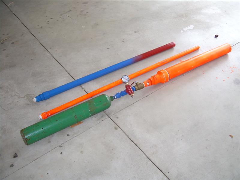

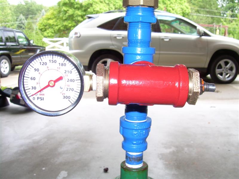

The chamber is 4" dia and about 25" long. My big disappointment was the threaded fitting on top of the cylnder is only .5" and I was expecting it to be .75". I think the larger opening would have significantly improved the performance. I experienced that some ammo descintegrates when I open the ball valve. I think it is because the air is being forced through such a small opening at the top of the cylinder, but I'm not sure.

Nice cannon, I've moved it for you. You should get a better valve, you have a PVC barrel with a DWV fitting on it, I doubt it will hold extreme pressure so you may as well have fun with it at around 150psi with a better valve, better yet make a piston a valve and take it up around 400psi.

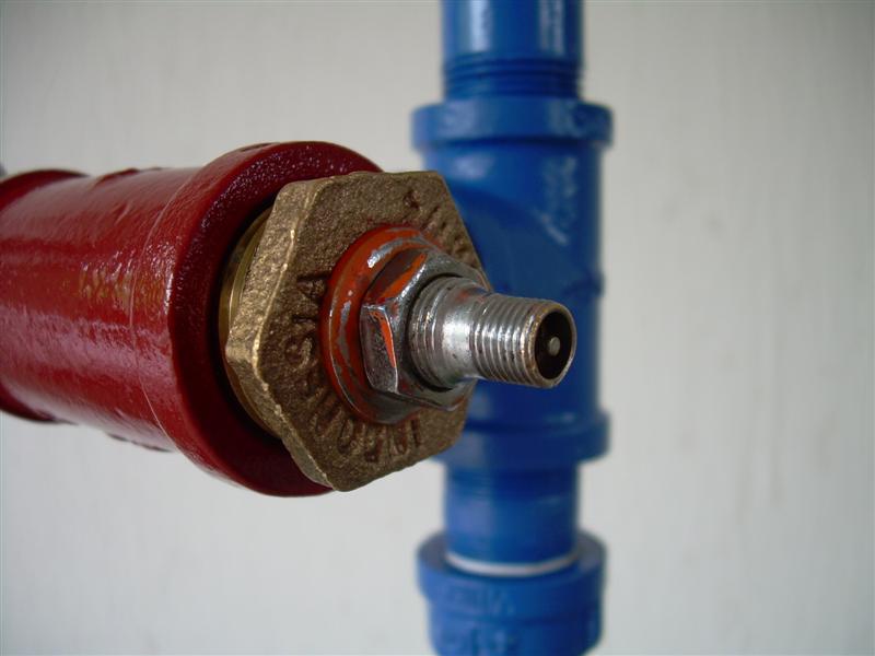

The barrel is the "weak" link in the system, next to the shraeder valve. The valve is actually not a DWV fitting. I think a DVW fitting would be a plastic pvc fitting? It is a brass ball valve. The data on the valve indicates it is rated to 600 or 900 PSI, I don't remember. It is rated for gas.

Yes hubb017 is correct, i was referring to the bell reducer on your barrel.
To get optimum performance I sugest you either
1) Get a metal barrel and take it up to 500psi+ and get good performance.
2) Build a metal piston valve and get a metal barrel for it and take it up to at least 400psi+ and get incredible performance
3) Keep the plastic barrel, swap it for a sprinkler valve and keep it around 135psi and get good performance.

The plastic barrels are left-over from my old PVC pneumatic. The large barrel is actually the old pressure chamber with one end cut off.
I think before I change the valve I need to learn how to build enough pressure inside the chamber. I have a little pancake air compressor, but it only goes to about 130psi. I can them pump with my bike pump to about 160psi.

Any ideas about how much pressure a good shraeder valve will hold? The one I sued seems to be of decent quality. It has a metal flange on the back with a rubber gasket that is compressed onto the inside of the reducer fitting by the nut shown in the picture above.
