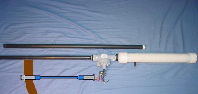

I always wanted to do something like this, it would make an easy way of making an efficient bullpup, having your blowgun pilot at the back without the need of a long hose so it's efficient, while having your actual trigger further forward so you can shoulder it comfortably. All you'd need is a couple of syringes (the same diameter will do but if you're crafty enough you can play with different diameters and resulting travel), some tubing and fill the lot with water.
Bad diagram to show what I mean:

i think that would be quite hard to do, how much of a performance difference would a smaller pilot volume give if you piloted like that as opposed to having a method like on spanerman's paintball sniper?
Sun Oct 21, 2007 4:44 pm
Theoretically, cutting the pilot volume in half means the pilot chamber will empty in half the time, meaning a quicker valve opening and therefore better performance.
As to actual percentages of performance increase, it gets a little complex - perhaps someone with a QEV/sprinkler valve cannon and a chrony could make a graph of pilot volume (ie pilot blowgun hose length) vs velocity for a given projectile?

jackssmirkingrevenge wrote:Theoretically, cutting the pilot volume in half means the pilot chamber will empty in half the time, meaning a quicker valve opening and therefore better performance.
i would just use a bigger pilot valve.
