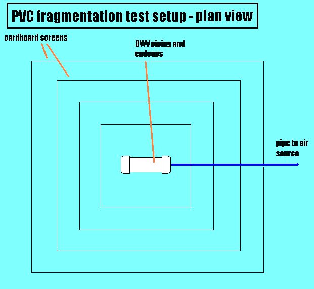

After seeing this failure, a though came to mind - wouldn't it be great if we could qualify the sort of damage that one could expect when a PVC chamber under pressure ruptures?
I live in an urban area with restricted space so I have no way of doing this safely and discreetly, but I'm sure there are those on the forum who could, if one were so inclined.
The idea would be to have a chamber built of DWV pipe and fittings, connected remotely to a pressure source. This chamber would then be surrounded by 4 cardboard rectangles of increasing size that would not only track the path of the fragments but also give an idea of penetration. In the event that some fragments escape through all four layers, the test could be repeated with an inner thin plywood screen.
Since the size (and consquently velocity) and distribution of the fragments would be more or less random, the test would have to be repeated several times for a valid result. This wouldn't necessarily require new screens to be built, but any damage from the previous tests should be individually marked.
Just and idea for those who have the time and resources, that would help us better understand the dangers involved and perhaps drive home the point that one should always use appropriated materials for the job at hand.

- pvctest.jpg (31.41 KiB) Viewed 6823 times
Is there a size limit to the pipe used? Also, does it have to be DWV (I know for safety purposes, this is what would be preferred) but what about pressure rated pipe bursting? Maybe someone can make multiple "bombs" of different sizes and pressure ratings.

I suggested DWV because few of us have the facilities to take pressure rated PVC to its actual burst pressure, which is usually significantly higher than the rated pressure. With DWV it would probably be reasonable (though tedious) to burst it with a stirrup pump - I don't suppose a 12" long 4" diameter DWV chamber would last for long over 100psi, probably less.Also, does it have to be DWV (I know for safety purposes, this is what would be preferred) but what about pressure rated pipe bursting?
What you could do is first see how many layers of cardboard a PVC fragment from the exploding chamber would penetrate. Take the same fragment and load it with a sabot in a pneumatic cannon, and alter the pressure until it penetrates the same number of layers as it did in the fragmentation test. You can then fire it at ballistics gel using the same pressure.hubb017 wrote:Incorporate Spudblaster's ballistics gel, since it is being used to test the grenade effect.
With a controlled CO2 / HPA setup, it shouldn't be too difficult to take either one to its limit.

If it blows under 150psi, and the first screen is over 20cm away, I doubt it will go through at all. I've had two PVC explosions happen when I was right next to the thing, one piece hit me in the face, I hardly felt it.
That would be greathubb017 wrote:If time and money permits, I'll try it. My wife just "loves" it when I make things go boom.
I predict similar results at typical spudgun pressures - this experiment is more of a "mythbusters" style venture, in the sense that while everyone fears razor sharp PVC shards ricocheting about, we have no real way of saying how dangerous those fragments actually are.If it blows under 150psi, and the first screen is over 20cm away, I doubt it will go through at all. I've had two PVC explosions happen when I was right next to the thing, one piece hit me in the face, I hardly felt it.
I'm not saying "exploding PVC isn't as dangerous as you think, make your high pressure pneumatic launcher out of DWV" but at least we could put the scare stories into an empirically measured context.

Incidentally I'd wonder if the very large air blast wouldn't rip through the cardboard just by itself.
