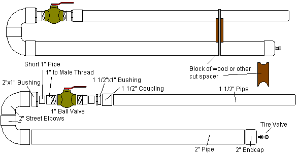

<div align="center">BASIC PNEUMATIC CANNON
Provided By - <a href="http://members.aol.com/sph911/spud/">ht ... h911/spud/ </a>
This is a basic pneumatic cannon, an excellent starting point for the novice of PVC mechanics. This cannon uses a simple twist-open ball valve that gets the job done, no need to mess with electronics. I built this cannon for my dear friend Connor, in fact these air guns are what brought us together, the man is incredible. He used this cannon in a play he directed, <I>The Cenci</I>.
This cannon performs well and is rugged.
MATERIALS.
1" Pipe (short sections for use as nipples)
1 1/2" Pipe
1 1/2" Coupling
1 1/2"x1" Reducing Bushing
2" Pipe
2" Street Elbows (Male and Female connections)
2" End cap
1" to Male Thread x2
Tire Valve
1" Ball Valve
Large block of wood and tie strap for space.
ASSEMBLY.
This cannon is very simple to build. The 2" Chamber should be cut around 4 feet, but can be as short as 3 feet and still perform well. It is a matter of preference. The barrel should also be around 4 feet. Drill a hole for the tire valve and attach it to the end cap, before it is glued in place. When all pieces are arranged, prime and glue. Let them sit overnight or you risk destroying the seal of the glue.
Adaptations of this cannon abound on the Internet. One cannon is 10 feet long and shoots 3" wide bean cans of concrete!
Provided By - <a href="http://members.aol.com/sph911/spud/">ht ... /</a></div>
MATERIALS.
1 1/2" Pipe
1 1/2" Coupling
2" Pipe
2" End cap
Tire Valve
1" Ball Valve
ASSEMBLY.

How many PSIs should i put in my cannon? What is the maximum before the joints come apart?

i just wouldnt use dwv and pw parts can hold a lot of pressure but 100-120psi is about as far as u should go. any higher is pushin it
