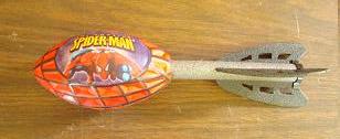

First off.. Thank you Spudfiles... I made this spudgun with information from this site..
.. I am in the Army and we train soldiers that are mobilizing on how to react in combat.. we try to replicate battlefield conditions as much as we can... sooo I figured... why can't we shoot nerf footballs at the convoys with a spudgun to replicate RPG fire.. sooo I started studying ... and got ideas from here.. my chain of command loves the idea and plan on incorporating it into existing training....
Specs..
3" X 30" barrel
4" X 35" pressure chamber
Modded orbit 1"
tire air valve
air pressure gauge..
Nerf syle "spiderman" football
"cool guy" digital style paint job
we use an oxygen bottle to fill it because it is easier while we are in the field...
video is short and not the best but it is accurate up to about 50m and at 45 degree angle will shoot over 200m.. the detonation in the last half of the clip is from a scopis device with simulates tank fire or IEDs...
Thanks again.. enjoy..
~Dan
Specs..
3" X 30" barrel
Modded orbit 1"
tire air valve
~Dan

Nice stuff, although in the second shot, it does sound like it's venting alot of air before it fires.

That looks great! It's cool to see a soldier on SpudFiles.
I would probably go with a bigger valve like an inch and a half but all in all it looks good and if it works for what you are using it for that's cool as sh!t

I went with the 1" because that was the largest valve they had at Lowe's, Menard's or Home Depot... plus they are 15 bucks or so.. and I looked at 2"ers online they were closer to 70... soo 15 bucks was easier to get the chain 'o' command to foot the bill for..

Very nice, good basic setup. Welcome to spudfiles and hope you stick around.
It could do with a longer barrel, you could probably cut 5" of the chamber, and add about a foot to the barrel to get better results.

That looks good but what do you pressurise it to.

There are a bit of modifications you can do to make it better but it looks like the performance is good for what you are using.
If you want to increase the performance you can always go with a bigger sprinkler valve or a piston and such.

Damn.. can't believe I forgot to mention that.. we use it at 80psi... I'd like to use a larger sprinkler valve... maybe I'll order one off the net.. what's the best site? I'm all ears to mods to make it better... just remember... I am not trying to put a hole in the HMMWV
.. I want to stick with the spiderman nerf ball too.. its very durable.. and cheap 2.99 at meijer..

You will see an amazing increase in performace if you double the barrel size.
