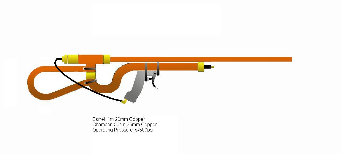

Well this is my latest design for this will be one of my last guns. It's based off the S400 and the SSS that Chaos previously built. I hate copying designs at all but his design is the most practical and clean for me. I take my hat off to Choas for first making what he did.
This is the idea I had planned:

Dident you call your last gun "the last gun"?
Just check GGDT to optimize it before you start building.

Cheers mate, thanks alot. Can anyone see anything that I could do to improve the design? I'm thinking of getting some 1/4'' copper tube and running that along the gun from the blowgun to the piston valve. it should give it a really nice look and feel. :D
Edit: Velocity told by GGDT:
100psi: 560fps
200psi: 747fps
300psi: 866fps
Not too great :(....

to imporve the design... hmmm well a QEV pilot would be a start if you are running at suitable pressures and the barrel obviously could be longer... and if you ditch the stock you could make the barrel longer, but the one thing i would reccomend to up the power is to up the pressure.

Well 300psi is about as high as I would go, maybe 350 if the pump I'm gonna make can take it. Qev's are very expensive to get in Aus :( I'm gonna make the barrel 120cm instead of 100cm and take the chamber from 50cm to 75cm.
Primarily, marbles will be what's used.

hmm marbles so they are about 7g.... well i have been planning something similar for a while and i'm using a 20mm copper barrel but 150cm long and i'm using a 28mm x 22mm x 28mm reducing tee (barrel side will be 22mm) with a 25mm piston and a 50cm x 28mm copper chamber at 400psi piloted by a 1/2" qev which won't be that much more powerful than your design because i think pneumatics reach a point where it is very hard to go over because normal air is reluctant to go over the spped of sound :roll:

Hmm with the gun I'm gonna build, what do you think the penetration will be like with a marble at 300psi?

Mitchza89 wrote:Hmm with the gun I'm gonna build, what do you think the penetration will be like with a marble at 300psi?
well a marble at 300psi will be going at 866fps according yo your calculations but i really don't have a clue about penatration but i can work out muzzle energy and momentum?
muzzle energy= just over 100ft/lbs
momentum= 0.004kg*264m/s= 1.056kgm/s

well i will get 2.something kgm/s with a 7g projectile fired from my 400psi beast (hopefully) so no :P thats because you will be firing a lighter projectile slower (a 4g projectile at 264m/s) wheras i will be firing a heavier projectlie faster (7g at 304m/s)
i might go work out how much momentum DYI's sbtakkankvnfk has...
edit: although the marbles fired from your gun will have more momentum (just) than .22 rifle bullets
40grain= 0.858kgm/s
38grain high velocity= 0.95kgm/s
31grain high velocity= 0.88kgm/s
