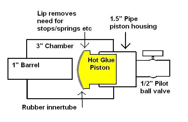

I looked at a lot of designs and found piston valves to be very complex (i have only before built basic combustion or ball valve pneumatic guns) i thought it would be easier to just make my own piston out of hot glue. I using a piece of 1.5" pipe as a mold i made a piston to fit. i set the 1.5" pipe on the round bottom of a pop can the glue pooled in the round section creating a mushroom type end to the piston (i almost cut it off before realizing that it would be the perfect stop)
I havent done much testing yet but it seems to be pretty powerful even at fairly low psi ( i was surprised at 40 psi)
Im just wondering what you guys think about what i consider to be one of if not the easiest piston to make for beginners.
Thanks for looking

I suggest you make the piston out of epoxy rather than hot glue. it will retain its shape better and is more air tight/rubbery (makes a better seal against the barrel). Otherwise, nice work. Can't wait to see results.

I think that lip will wear/break off with repeated use at higher pressures.

I dont think it is going to wear off (it is actually thicker than my quick drawing) but ill keep that in mind. the glue i used is more rubbery than normal hot glue too
I also glued a piece of rubber innertube to the top to make a better seal

jackssmirkingrevenge wrote:I think that lip will wear/break off with repeated use at higher pressures.
What would you use as a seal? Well what I meant was the frontal seal, bc that one wears as well right, atleas to my experience?

i know from experience that lip is completely unnececary. its easier to just put a bumper in the back................................

not sure what you mean by frontal seal ant... the only seal it has is a circle of innertube glued to it to seal the barrel...
and vh_man the lip wasnt intentional. it just happened the way i made it and i decided not to cut it off. this way the piston only has to move like an inch and doesn't smack into anything

Procrastonator wrote:this way the piston only has to move like an inch and doesn't smack into anything
The lip smacks the edge of the tube which the piston is travelling in, which has a small surface area and therefore exerts greater pressure on the piston structure than if you just had to have a bumper over the whole area of the base of the piston.
