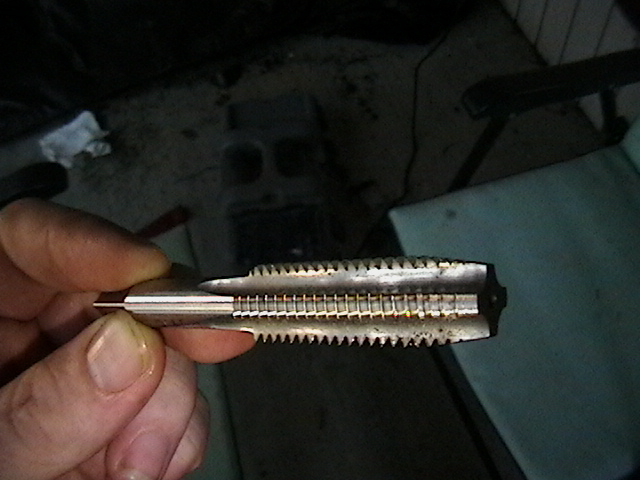

Use one of these. It cuts threads perfectly, the grooves remove the threads cut material as it cuts the threads deeper.
thread tap
thread tap

lol, thats not a "threaded drill bit", its called a tap :roll:
and i would epoxy if u can
