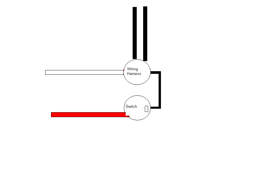

I drew up a quick sketch to help with my wiring dilema. The red wire is obviously the live wire, as it has the switch between it and the wiring harness.
Then im still assuming that the white wire is the other wire for power. But then, i still have the two black. WHAT ARE THESE? Its bugging the crap out of me man.
Even if they arent important i would love to know what their purpose is
Also, if i tilt it on its side, wont that jsut put more oil into the air line?

If you took an ohmmeter you could probably find the coils and how they're arranged, mabye that would demystify the black wires.
Since you're going to a school for electrical engineering, a simple multimeter may not be a bad purchase if you don't have one already.

first of all there are several possibilities here.. so do not take anything as 100% sure
+these things normally have problems with starting up. Mine runs for up to 5 seconds then it stops and then after ~15 seconds everything repeats..... all in all it takes ~ 2 minutes for it to warmup enough to run continously....
+firdge compressors (and probably AC compressors as well) have a circut which doubles the current going to the electric motor when the compressor is starting up. There is a possibility that one of the extra cables has something to do with it....
now the best thing you can do is to do what turbosuper said... and check how the compressor was wired when it was still a part of a window compressor.

the easiest way to find out how to hook up a fridge compressor is to check how it was wired when it was still a part of a fridge... really...
check where all the cables were/are going and find out what these two black cables were supposed to power
oh yeah sorry I had very little time (work
) to replay to both your post and the other one (about an AC compressor) when I wrote my last post so I acccidentally mentioned AC in yours
at least others can contribute or help
Ive heard of oil coming out of the air outlets more times, it is normal and will probably stop doing that in some time.
Just make sure that it does not spit oil into a cannon.
If it runs just fine without the black wires, cut them off and insulate.
