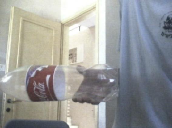

I want to use a plastic soda bottle, but I don't know if mine is
good, I can squeeze it, Can I use it? Or I need another kind of soda bottle:
I can squeeze it.
I can squeeze it.
Picture 20.jpg (21.58 KiB) Viewed 4439 times

Mon Oct 13, 2008 7:07 am
If that's a coca cola bottle 1.25L then you're in luck. I've actually tested it when I was making portable pre charged air tanks for my BBMG's and don't worry it should be able to handle up to 100PSI with no problem. You can go higher if you want but 100PSI is probably the most safe bet since they're not pressure rated, shouldn't try to go any higher... but I will, you can if you want and report back.
And yes don't worry mine was squishy too and it could handle the pressure. Worse case scenario bottle breaks, you probs drop your nuts in surprised but not injuries will sustain... but where glasses JUST incase. Every precaution counts you know.
It's Nerf or Nothing.

Actually, I'm using a 1.75L plastic one, Do you thing it can went up
to 110-120 psi with no problem?

elad311 wrote:Actually, I'm using a 1.75L plastic one, Do you thing it can went up
O, and, Can you give me a link to a video or a picture that shows
how connect the bottle to the valve with no leaks?
Umm 1.75L should be fine too 110-120PSI should be fine and if it blows up cost like 2 bucks to replace anyway + excuse to drink coca cola <,<.

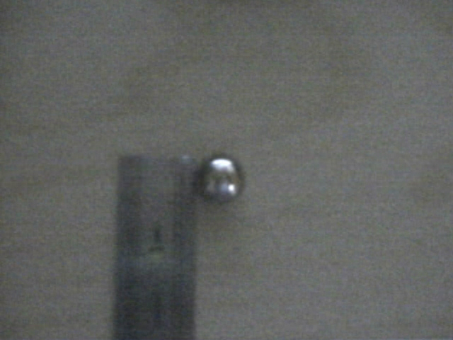

Well, I have an awesome ammo for this: a 1/2" metal ball,
But what do you mean 1/2" barrel with 3/4" valve?
Can't that make an explosion?
A pic of the ball:
The 1/2&amp;quot; metal ball.
The 1/2&quot; metal ball.

elad311 wrote:Can't that make an explosion?
:lol:
No, not at all. Many cannons have a larger valve diameter than their barrel diameter, which provides a higher air flow to the barrel, and thus more performance.
Indeed, my cannon HEAL has a barrel with a 20.3mm bore, but the valve is 22.1mm across internally, which helps promote it's performance - it's not blown up yet.
