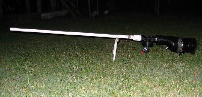

This is my first pneumatic cannon. It has a 1/2 inch metre long barrel, almost perfect for marbles.
Due to the pvc glue drying too quickly i was unable to give a half twist for the main body connection, therefore creating a few leaks (hence the reason for the all the glue crap round the chamber).
At 30psi a marble dissapears out of sight. Any tips to add more power to this baby would be appreciated.
![Twisted Evil :twisted:](./images/smilies/icon_twisted.png)
ps. pressure guage is on the underside of the barrel.

a good trick i no is to add some wadding behind the marble,makes a better seal..not like u could ask for a better one..but it does increase it slightly.
you could always just add more psi,but wat type of pipe did you use?use sch 40 and u could go to 90-100 psi.

i dont know ifs its schedule 40 or not; although it says on the piping that its DWV; does that mean its schedule 40?

Well it will state if its pressure rated and if it doesnt say it is then it isnt,which is dangerous and shouldnt be used.the type of pipe you should be using is a sch40 NSF-PW ~pressure rating here~ pipe and remember if it doesnt have it printed on it then it isnt pressure rated.saftey first and also u wont have to fork out more $$ because it shouldnt fail,so go the high quality pipe and fittings its safer and cheaper in the long run.

made a breach loader; works great. the guy at the plumming supplies store reckoned the pipe was pressure rated, even though it didnt say so on the piping. just to be safe im gonna re-do the whole chamber.

well when its all done get some updated pics and post em
![Razz :P](./images/smilies/icon_razz.png)
a breach loader,nice and maybe some dmg pics
